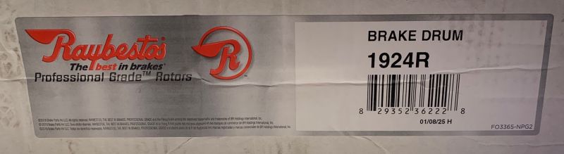

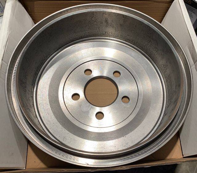

back when I had a brake issue with my son's Jetta I found out through a recall notice that his master was sold as Raybestos, NAPA, and AC Delco...it came from Brake Parts Inc which also owns Centric, and they are owned by First Brands (Fram etc) which just filed for chapter 11...I think most of this stuff comes out of the same Chinese factory as there isn't enough demand for anyone else to make themAbout a week ago I ordered 2 pairs of drums (11 x 2.75 and 11 x 2) for front/back. Ordered from rock. Both pairs being Raybestos brand. 1924R and 2955R. I got the 1924's today. They both have no welded balancing weights. Just like my "WinHere" china brand 11 x 2.75 drums I bought late last year and have had nothing but problems with them (out of round, and not balanced). These 1924 Raybestos drums came in a white box with a Raybestos sticker on it, but did say made in china somewhere on the box or maybe even the Raybestos sticker. What pisses me off is not necessarily that they're made in china, it's that they're obviously not balanced. Balancing a drum is important, for ride smoothness, moreso than for a rotor.

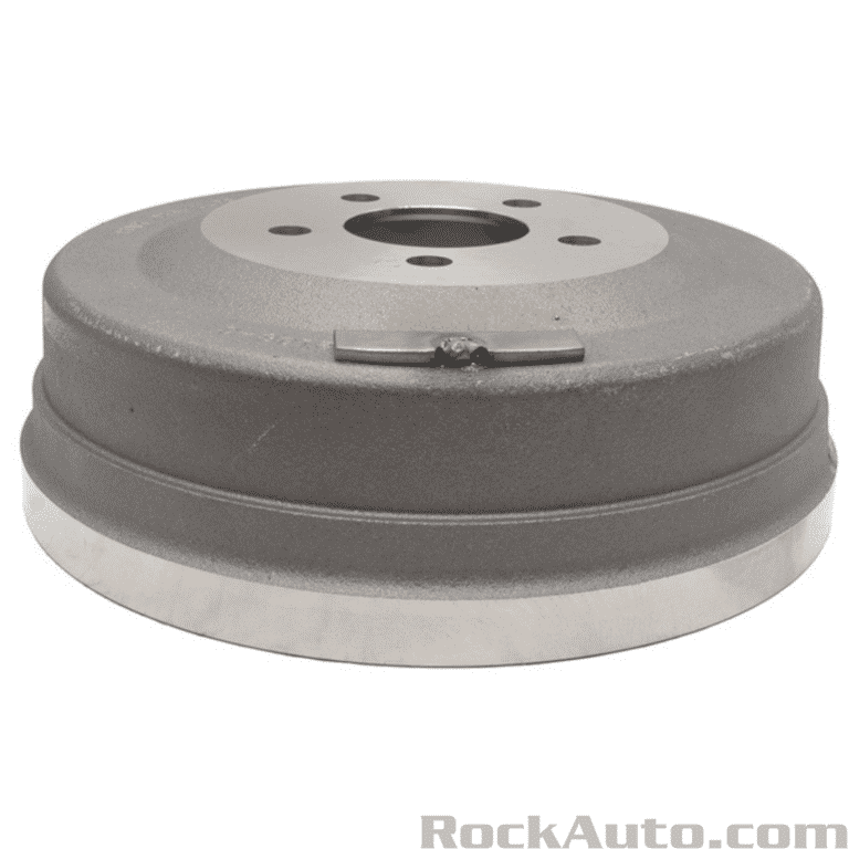

I am Pondering the 1924's From Rockauto (raybestos). Did you use them or return them? I really do not want to press Front hubs on Junk drums ,Luckily i am in no rush to obtain Decent drums .I see on RA they Now have only one drum available.Their pic shows Weights although Their pictures can be very Inaccurate ! Your thoughts on the RA 1924's would be appreciated.

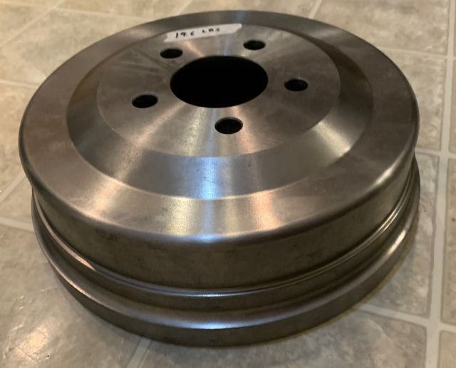

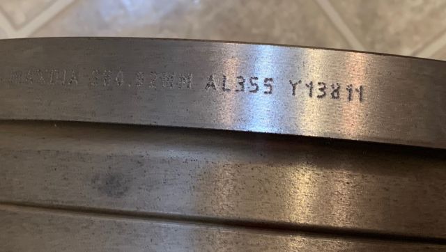

In my estimation, with modern numerous-axis CNC machining, robotic parts loading/removal, etc, that it is a simpler mfg process to machine them all over than to create a separate balancing station with whatever weights/attachment technology is needed for it.
But now that I've said that, here's a pic of a 1924.
