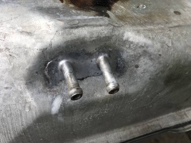

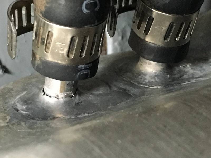

Check the vent lines, mine needed to be fixed.
Alan
They heated it up real good to the point the original solder flowed and mixed in some new.
The original was a cold solder joint, they didn't get the metal or the tubes hot enough to start with.
After
Alan
After
Alan
Since my tank had gas in it by the time I discovered the vents were leaking, I had to go with a "gas tank repair" kit to fix the problem. Wish to hell I'd seen the problem earlier. . .
I had a FULL tank, drained it and sent the tank to a radiator shop, car was down five weeks. I took advantage of that time to do some work to the bottom of the trunk pan, a repair I wasn't happy with.
Alan
Alan
Maybe, if my tank leaks again, I'll do the same thing. Really ticked me off to hafta deal with a leaking new tank.
Dang, that really BLOWS. I will have to inspect my vent holes carefully, I can't have my car down for more than a day!
Old tank is leaking from where it flexed enough from collapsing; the sheet metal fatigued and cracked. That "gas tank fix" stuff worked, though.
Sounds like your tank was not properly vented. . .
