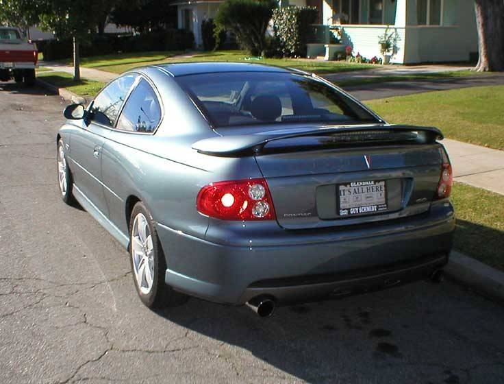

...to et at the drain plug and filter, as the last-gen GTO has)
It's funny you mentioned the last-gen GTO. I owned a 2005 brand new; my first brand new car and the fastest car I've ever owned. At 400hp/400lb ft it could really move. Anyway, I remember oil changes being $90 which I thought was expensive.
