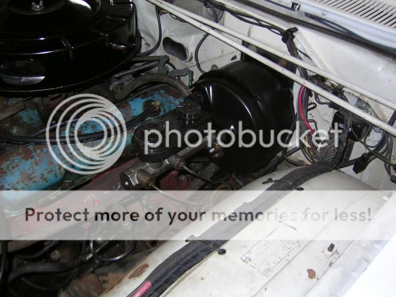

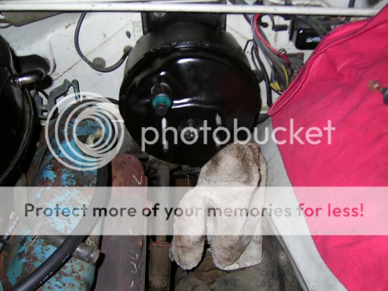

Here is the set-up I did on my 68 T/C wagon. 73 C-body disc brake set-up, with a Cardone replacement 68 disc brake booster, and an aluminum MC from a 80-90's Dodge ram van or truck...and an adapter to go from 4 bolt MC to a 2 bolt MC.

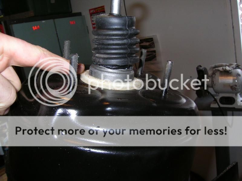

Here is the part of the booster that won't clear you firewall hole....the hump below the rubber boot.

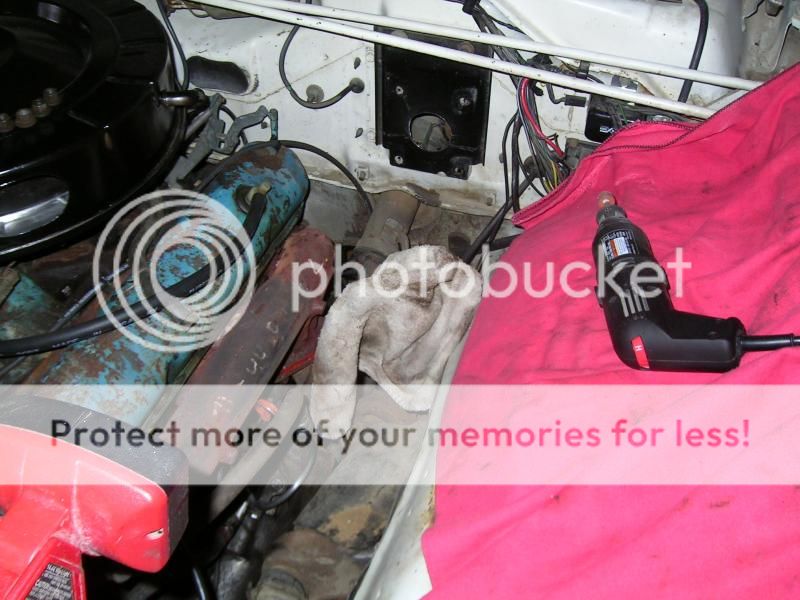

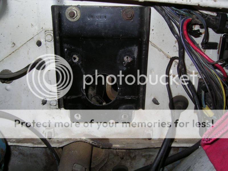

I used my dremel to open up the hole...
Then installed the new booster...you can see it doesn't look correct for a 68 Disc booster...but functions the same.
And then the adapter and new MC.
I had to adjust the push rod length coming from the booster to the MC. But other then that it works great!
