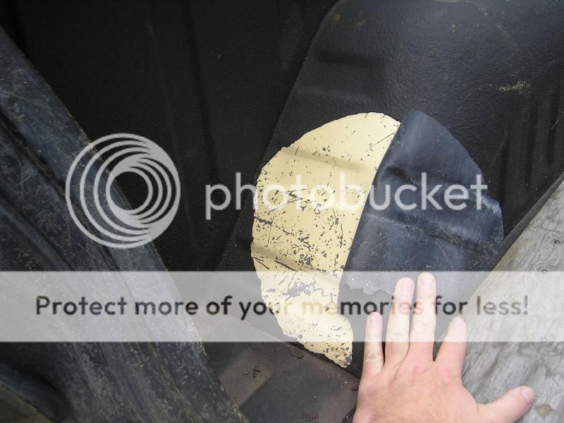

First area I picked at...
Then a few days later. This was just a few seconds worth of picking.

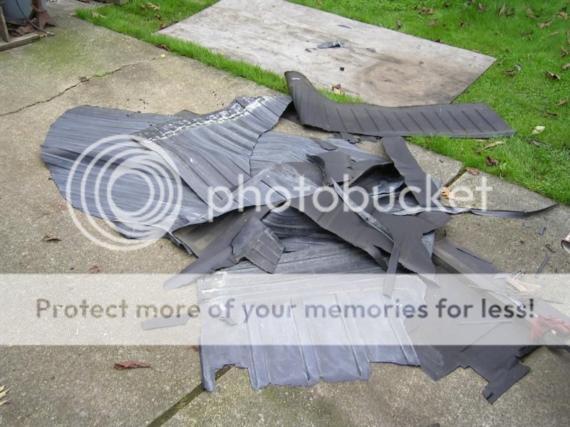

Took less than 2 minutes to strip this one side....

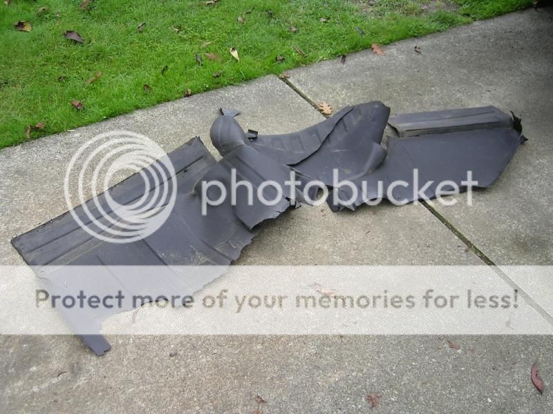

And the rest took only a few more minutes between myself and my friend.
Pictures are wroth a thousand words aren't they...;)
Looks like it's not worth much. Or a very, very, very bad job of applying.
Glenn
Didn't clean OR rough the surface up! They are supposed to take a sanding wheel or disc (or similar tool) and rough up the surfaces so the material will stick to the metal. Looks like the probably didn't even clean the area first with the right cleaner, either. Poor prep on their part, for certain!
Maybe because all my trucks have been brand new when I had it isntalled Ive never had a problem. Ive scrapped heavy stuff across it and was amazed never came off. I would assume there has to be some sort of prep work done. Id sand down that bed and make them reapply it.

They did zero prep!
My factory spray in liner would take a chisel to get it off. I also had the undercarriage Ziebarted. Eight years later...no rust or deterioration anywhere.
Yes the prep work sucked, that's for sure!
