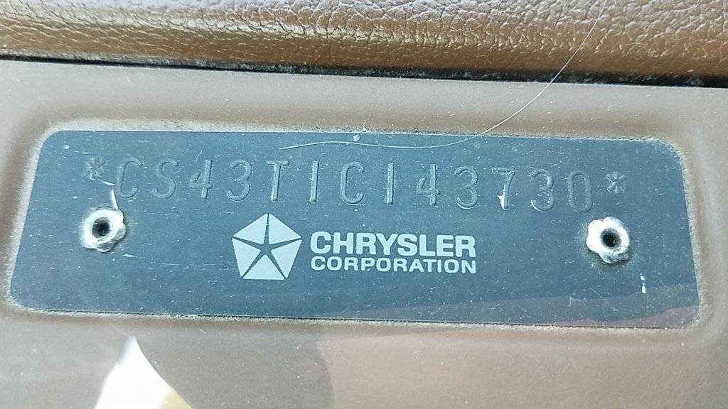

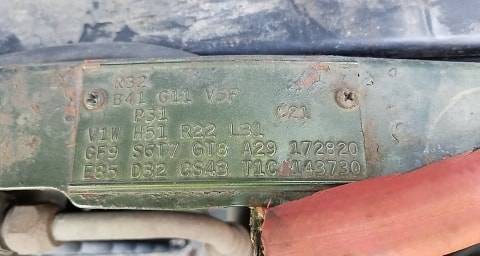

I appreciate all the input. Can anyone help me decode? I'm working on it but I'm sure there are some here that are faster...
Look Correct?
CS43:
Chrysler
Special
4 Door Hardtop
T1C: Unknown
1971
Jefferson Avenue, MI, USA
: Sequence number
E85: 440 cid 4 barrel V8 350hp
D32: Heavy Duty Automatic Transmission
GF9: Unknown Exterior Color
S6T7: Trim - Unknown, Vinyl Bucket Seats, Chestnut
GT8: Dark Tan Poly Int. Door Frames
A29: Build Date: October 29
: Order number
V1W: Full Vinyl Top, White
H51: Air Conditioning with Heater
R22: AM Radio with 8 Track (10 Watts)
L31: Hood/Fender Mounted Turn Signals
P31: Power Windows
C21: Center Front Seat Cushion
B41: Front Disc Brakes w/Standard 10in RR Drum
G11: Tinted Glass (all)
V5F: Body Side Stripes, Green
R32: Dual Rear Speakers
CS43
C - Chrysler
S - Special
4 - 4 door
3 - hardtop
T1C: Unknown
T = 440
1 = 1971
C = Plant of assembly (Jefferson)
