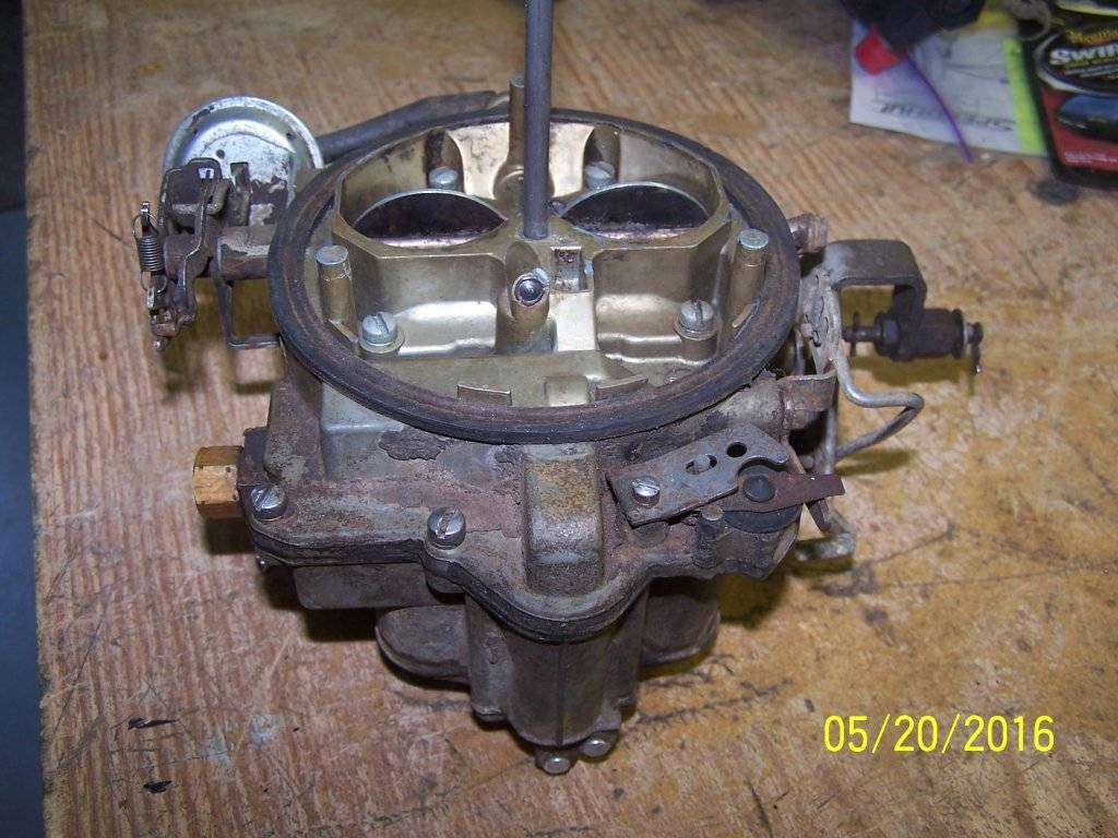

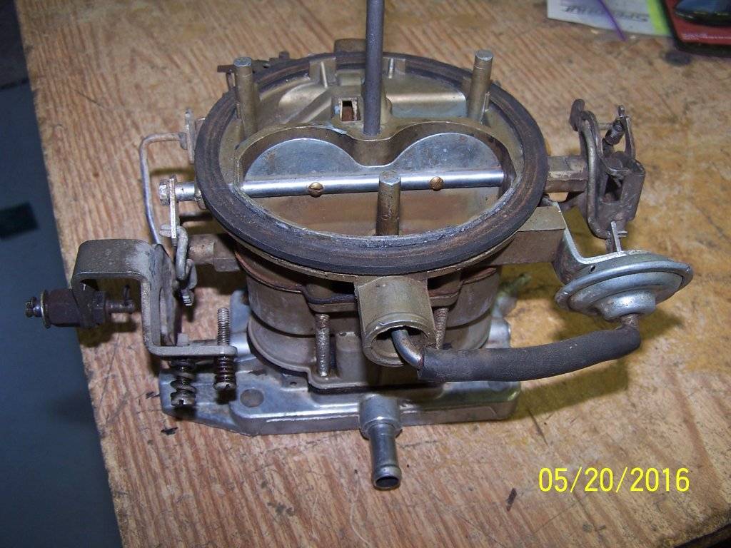

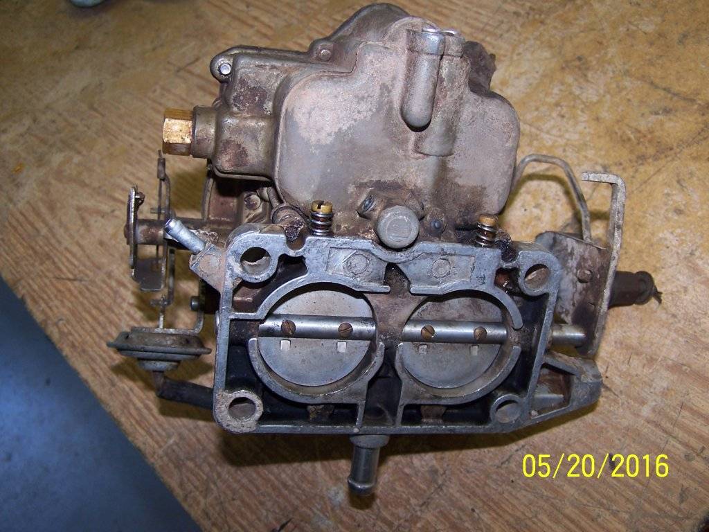

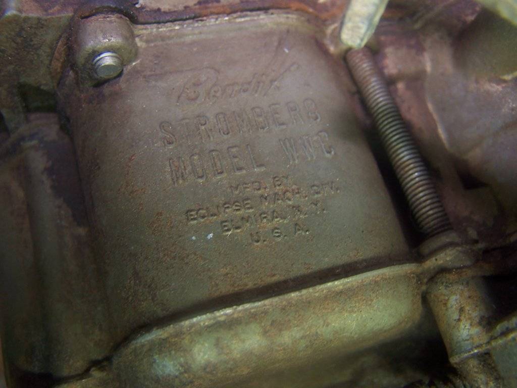

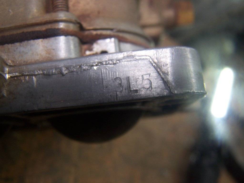

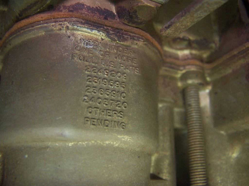

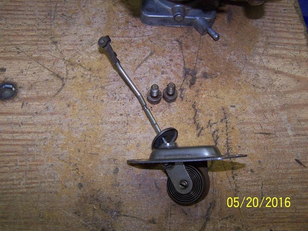

Bill, It appears this is the right carb for your car although I didn't see the 3-262 on it. I found what looks like 3L5 on the base. It ran great on the 66 Fury I bought from a guy years ago. The K frame was rusted bad so I parted it out. It has been sitting in my loft for about 20 years so will need a kit but it is not stuck and is complete with the choke. Here are some more pics I took today. $65.00 shipped to you.
Thanks, I’ll send a PM later today.
