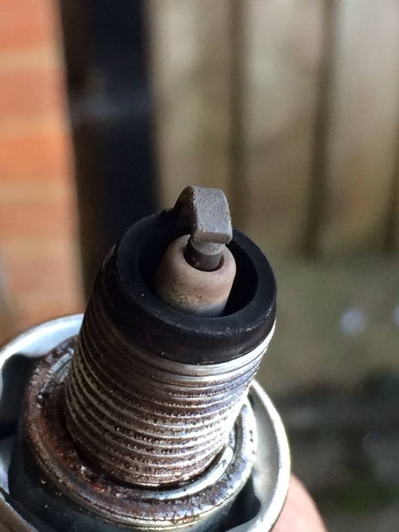

Pretty plug Knebel. Makes me think of something else - Should I use a different plug than a Autolite R45S? Maybe a hotter plug would be better to burn all in the engine, then it wouldn't have raw gas going out the exhaust. You show a plug with much longer threaded area.

I actually prefer Autolites in my engines with factory iron heads. Champions for stock type engines. I find I can read the Autolites easier and they last a lot longer with hi-powered ignitions. Autolite 86, or Champion J14YC. But plugs won't solve this. You need to find what's not right.

Thought of another thing too. I think it was Knebel that posted a pic of a really nice looking plug and it occurred to me that maybe some trouble may be coming from using the wrong plugs. Are Autolite R45S the right ones for this radical an engine?

oh hey thats a random plug. not mine. Just as a reference for what you want it to look like (or close to it). A hotter plug wont burn all the fuel when its too rich! Dont worry, you will get this figured out. Heck, I bought an EFI system 2 years ago and am just starting to REALLY tune the quirks out.
