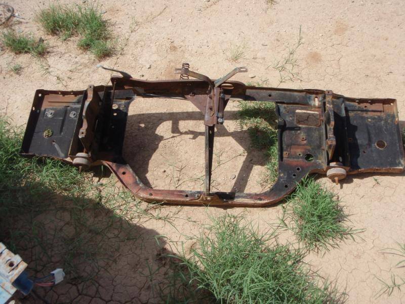

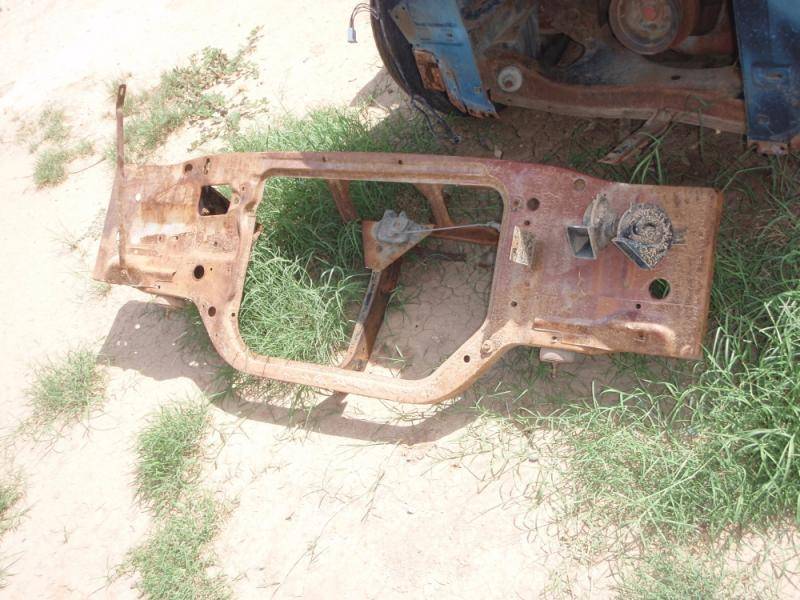

It's not NOS but I have a good used core support for a 26" radiator that came out of a 70 Polara. If you want it it's yours for the price of the shipping.sounds like a plan........maybe one of the guys from Finland will want it, I'll go back to a fox body Mustang, at least I can get parts for it instead of having to use my reg car on a day like today. Or I can find that guy who had the nos rad support for a 26" rad.......prob gone by now though.
Yes. The opening for the radiator is the only difference I believe. On B & E bodies with the welded on core supports all you do is change the closeout on the passenger side. Of course you have to drill out spot welds and then weld it back in. On this 69 RR I changed it from a 22" to a 26".Not to sound stupid or nothing but the 22" and the 26" radiators each have their own radiator support?

I asked because on my 66 with a 22", a 26" slipped right in using the same mounting holes. The 22" radiator simply had wider mounting brackets.I'm not sure on the slabs Stan but the opening has to be different to fit the radiator. Most of the slabs I've had were A/C cars with the 26" radiators so I cant remember anything different.
