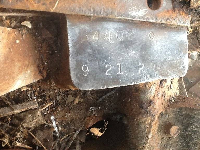

So - one of my 440s has a diamond on the stamping on the pad that indicates oversized lifters. Where does one get new ones?
View attachment 703755View attachment 703754

I'd say to measure before you put any money into this.
AFIK, there are no oversize lifters available. IMHO, there's three options. One is finding another block (obviously).
Another is having the lifter bores bushed. I don't know the expense on that, or if there's any shops doing that work anymore. One race engine builder I knew did that all the time, but that was years ago.
The last option I have is to have your original lifters resurfaced. That would also let you use the earlier push rods. I have a local guy that can do that if need be. He did some for a flathead I did when I couldn't find new lifters.
Regarding the crank, I'd have it ground .010/.010 and get the corresponding bearings. I don't know if a .001" undersize bearing is available anymore.
if one the parts book gurus on here could look up the pn for the oversized lifter the pn can be run on the locator to see if any are out there.
That diamond is indeed indicating that you need to measure them, as they may not all be done that way..... if it's only a couple, that would certainly cut down on the cost of the bushing job.
I have a C body block that had oversized lifters . Only on one cylinder. They ground a flat on valley at the 2 affected.
I did not pay attention, as I was young and had already thrown away the cam and lifters.
Put a purple shaft in, and those 2 lifters made a bit of noise, but never went flat. Got north of 50k on it.
Still have it. Will bush when out and apart next time.
When in doubt have a machine shop measure and bush any over sized holes! A good machine shop won't charge too much to do this.
By the way, any big block Mopar should have every lifter bore bushed to be effective. Just my opinion.
