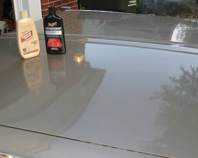

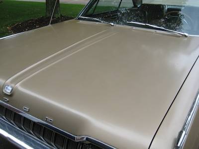

Here is the best i could polish the hood and deck lid before.

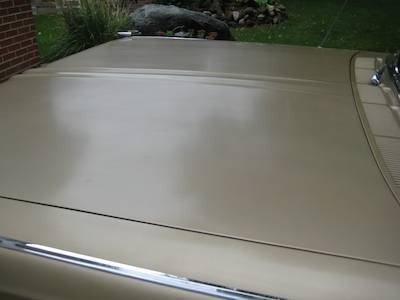

Here is the deck lid after wet sand and polish. Notice the difference in the reflection sharpness.
And the paint is smooth as glass. I'm pretty happy with it figuring it's a 30 yr old Maaco/Earl Schieb type paint job. I need a lot more polishing pads for the big polisher. They really load up during the 1st pass with the polisher.

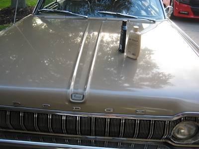

Wet sanded the hood out tonight. Used the same 1000 then 2000 grit sanding pads. The rear deck turned out so well i spent a little more time sanding, rinsing, sanding then final rinse and towel dry. I loaded up 2 pads first pass on hood. Used a 3rd pad to clean up the whole thing.
Let it dry while i ate then applied wax with the still clean 3rd pad. I used a foam pad on the big polisher after wax had dried to a haze. This is the way to go as apposed to the orbital polisher or hand polishing. I used to hand polish the last application to minimize swirl marks but the foam pad works great with no swirls.
Smooth as glass and towel slid right off the hood!

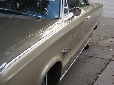

Might be hard to see the comparison between top of front fender, door panel top (not touched) and rear qtr. top done saturday. I want to polish out the rear deck again.
But, now i opened a can!
I gotta do the whole car since the hood came out so nice. At least all the horiz and upper panels. The polished panels are also a bit lighter like the original light Pale Gold Poly paint chips show.
