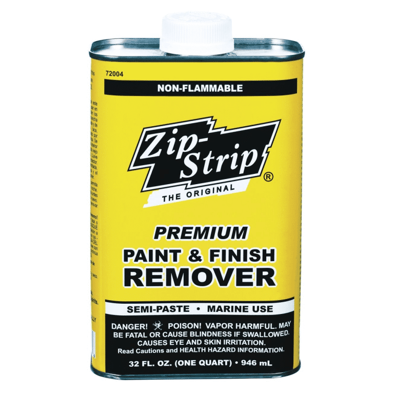

this stuff used to be good but who knows now that everything has been made safe and useless.
Aircraft Stripper used to be really good but they made it safer to the environment and reduced it's effectiveness.
Agreed.
Once again, thank you California.
Actually, I don't think it's an environmental problem. It's a toxicity issue. The stuff that was in it, methylene chloride, is pretty bad stuff. Not only breathing it, but it's also absorbed through the skin. It's the same stuff they used in model airplane cement and there are a bunch of folks that huffed that with bad results.
I seem to remember something about a bunch of guys stripping bath tubs died while using it with no ventilation.
