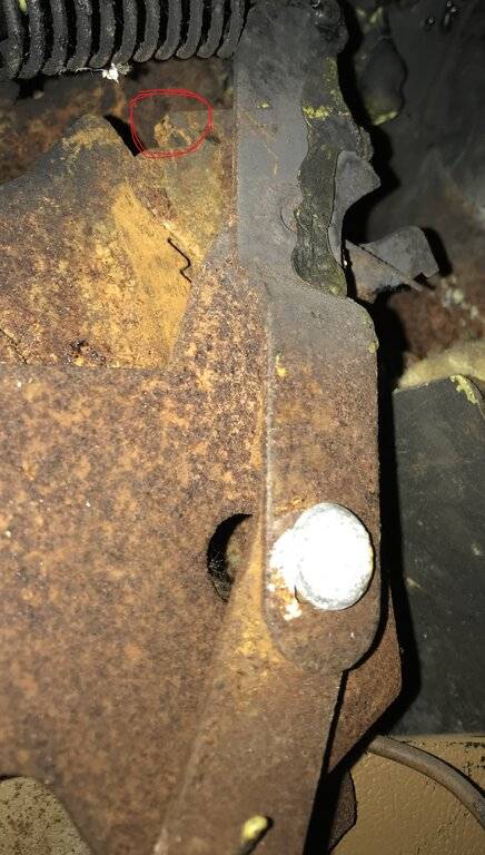

    Tooth broke off the lock. Parking brake still works good, here in flat Northern Ohio, but only if I keep my foot on it. Can I just grind that one hinge bolt off and replace the lock assembly or weld a tooth on?
    Looks like a huge pain to take whole parking brake assembly off. I'm thinking the front fender has to come off to get to the whole parking brake assembly? Thanks guys!

    It looks like you have a rust problem that caused the pawl to break off. You should replace the whole pedal assembly. Is there a big hole in the cowl above the parking brake assembly?.
    Dave

    No, it’s all of three bolts. Once the assembly is out, the cable will un-clip from the back. Best to replace with another other assembly.

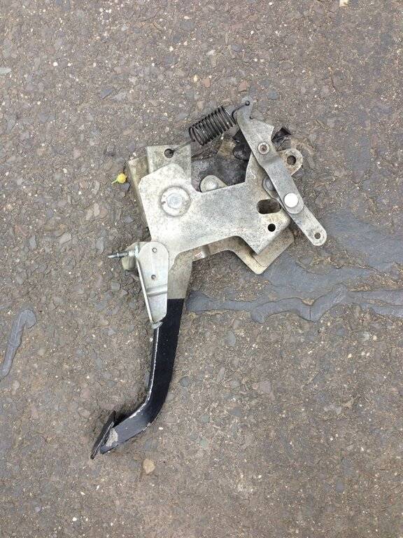

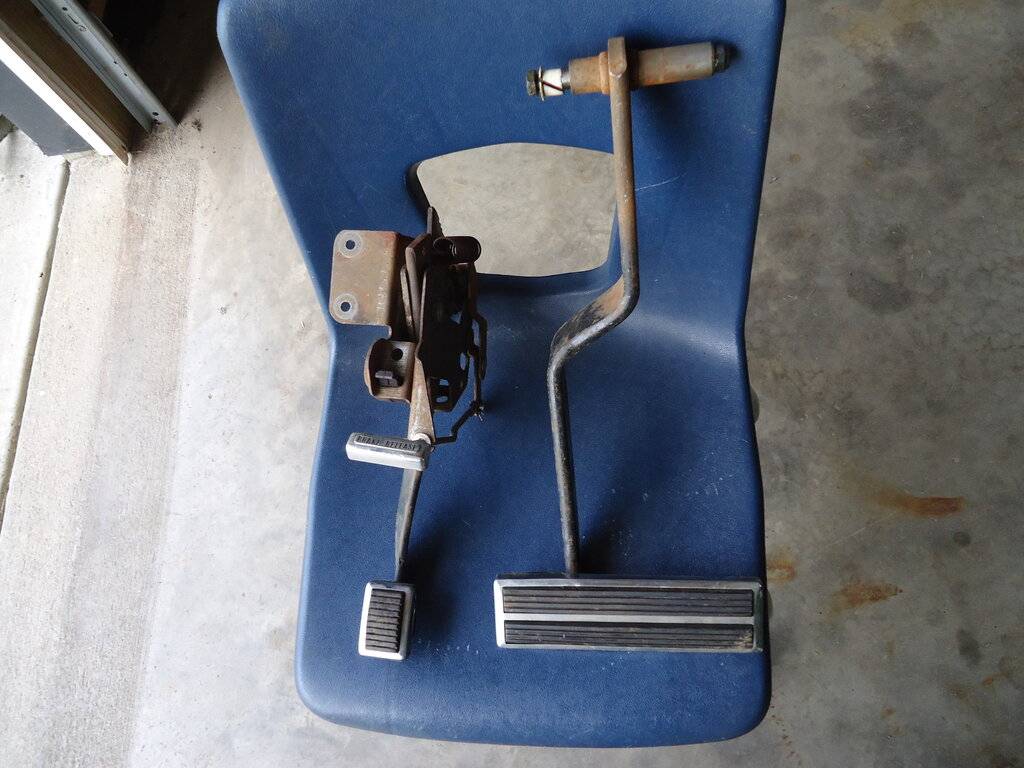

    You did not say what car you have but I have one off a 1970 300. $50.00 plus shipping.

    Thanks for the great info guys. I didn't see those bolts since about 20 million old wires were in the way. Not much room but If I'm able to get it out, I'll let you know if I can weld it or if I want to buy another one from one of you.
