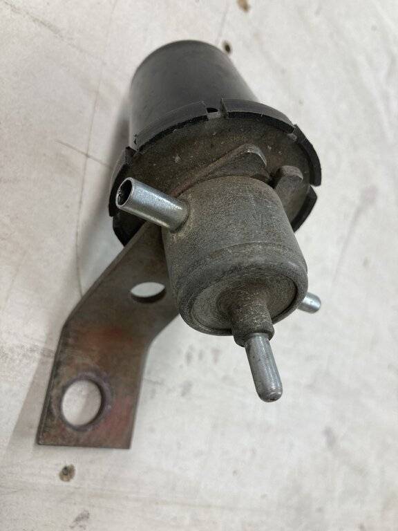

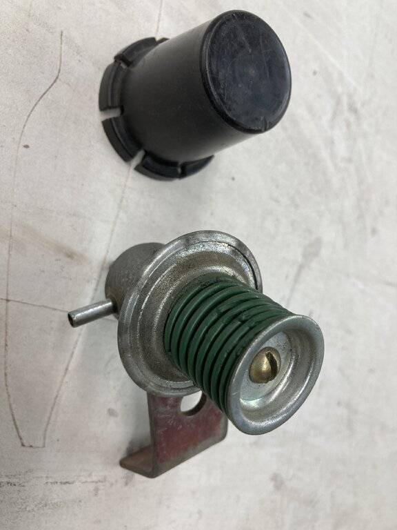

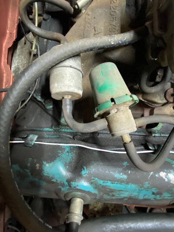

Hi Guys, I believe this was something on the 67 CA cars for NOx reduction. It sits between manifold vacuum and the vacuum advance canister on the distributor on my 67 Fury 383. It oddly has what appears to be a Mopar fuel filter between the manifold vacuum and the green capped part. ANY input is appreciated - I believe it came from the factory or dealer like this.

Well duh, I forgot to add it, I had it saved and forgot, sorry here it is:
Well I don’t know what it is or if it’s factory but I’ve had one of those oddities on my shelf for a few years without being able to identify it so I’m very interested. It has no part numbers on it.
Early aftermarket NOX reduction control, toss it. Required back in the day for Ca smog inspection's hook vacuum lines back up per factory.

... It sits between manifold vacuum and the vacuum advance canister on the distributor on my 67 Fury 383. It oddly has what appears to be a Mopar fuel filter between the manifold vacuum and the green capped part...
Is the vacuum advance on your distributor attached to ported vacuum on the carb, or solely sourced to manifold vacuum via this NOx stuff?
If not on ported vacuum, it needs to be.
I respectfully disagree as Chrysler developed the CAP valve and it was installed standard on all vehicles destined for California. It is not an aftermarket item per se.
Automotive History: Chrysler’s CAP, The First Effective Exhaust Emission Control (With ’63 Dodge and Dart Road Tests)
It is also described in the factory service manuals in the approximate 1967 model year and later................................
