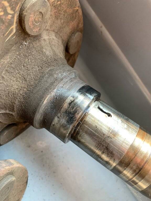

Looking for so guidance on a rebuild of axles for a ‘65 Chrysler.
After removing the bearings and retainers from the adjuster side axle, we noticed this slot. Is this normal?
NC300
No, some idiot burned off the old bearing with a torch, that axle is unsafe and is junk. Heat should never be applied to any axle.
