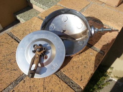

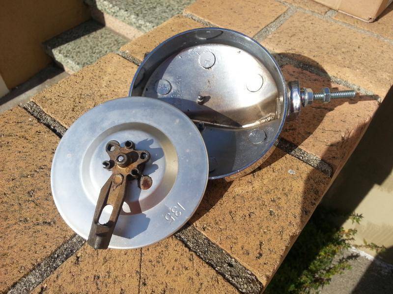

As Fratzog said, you need to remove it from the door. Don't know if your mirror is the same as mine, but on mine a bolt and nut and machine screw secures it to the door. Once removed, on the bottom of the mirror is a phillips screw that holds the mirror asm. Remove the screw and the mirror asm lifts out as shown in the photos provided.
