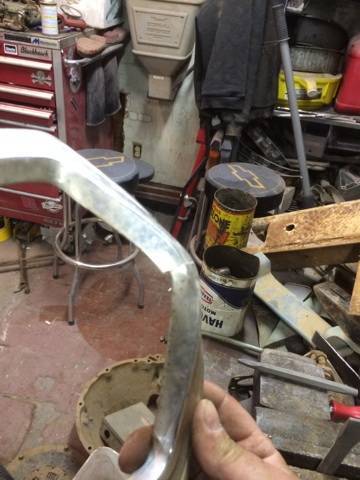

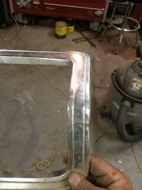

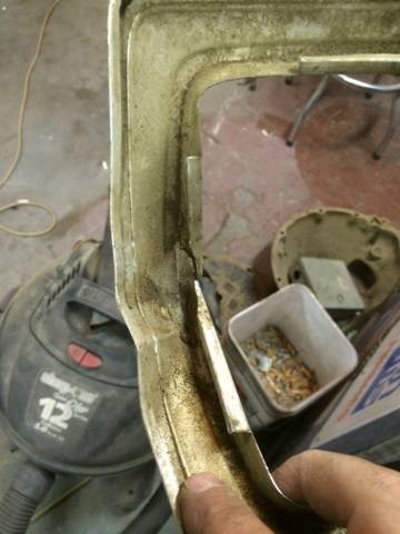

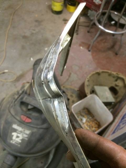

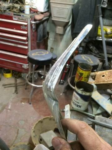

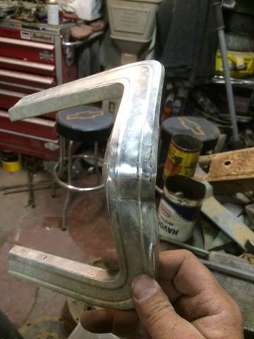

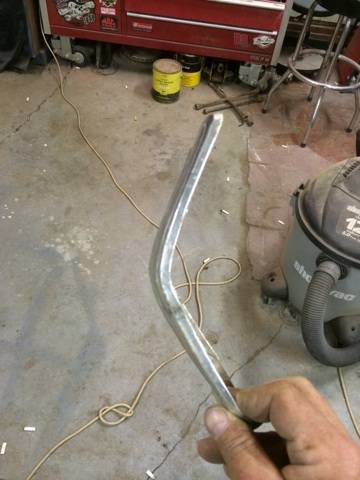

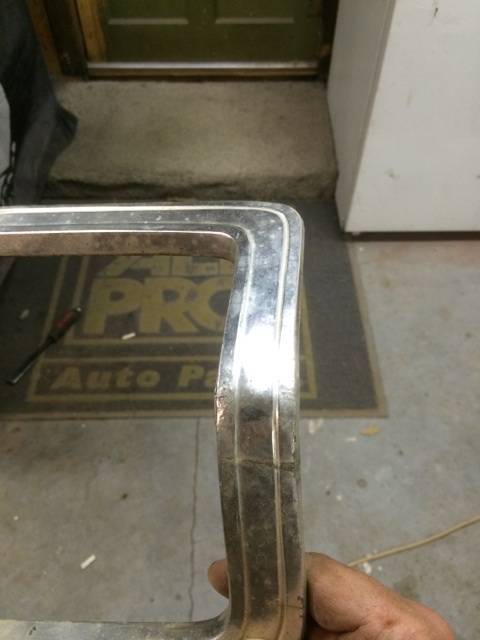

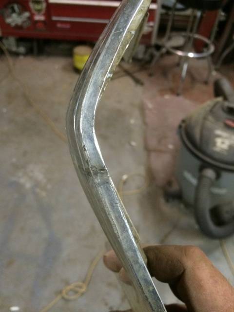

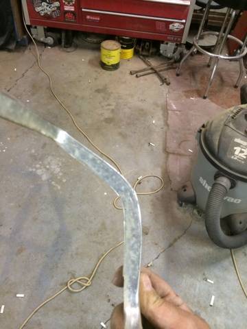

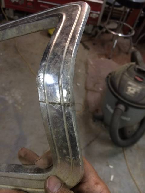

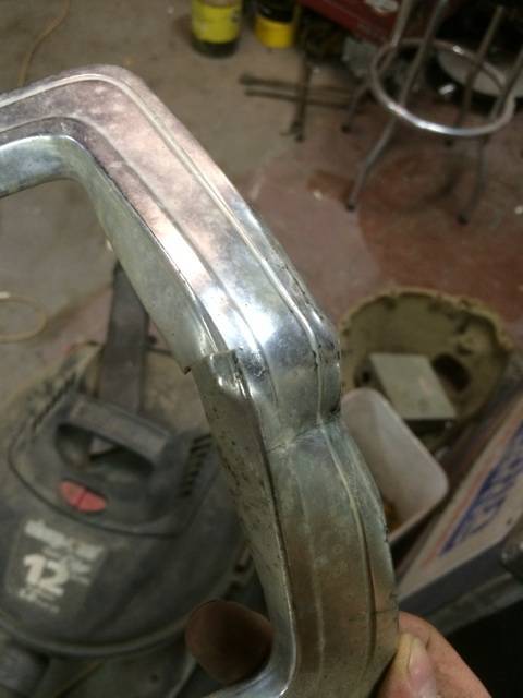

IMG_1535.jpgIMG_1543.jpgIMG_1542.jpgIMG_1541.jpgIMG_1540.jpgIMG_1539.jpgIMG_1538.jpgIMG_1537.jpgIMG_1536.jpgIMG_1544.jpgWell last night i decided to play around with the U trim we have for the tail lights. This was the worst piece i have as far as tail light trim. Started of with my body hammer on the lines to get basic shape back then a flat punch and chisel to help define it a little more. I have about 2 hours it this piece and i belive with a little more work and some sanding and polish i can make it look pretty darn good. (passable):os_dancing2:
Are they saposta be black in the center or all polished? I think all i've seen are polished?
