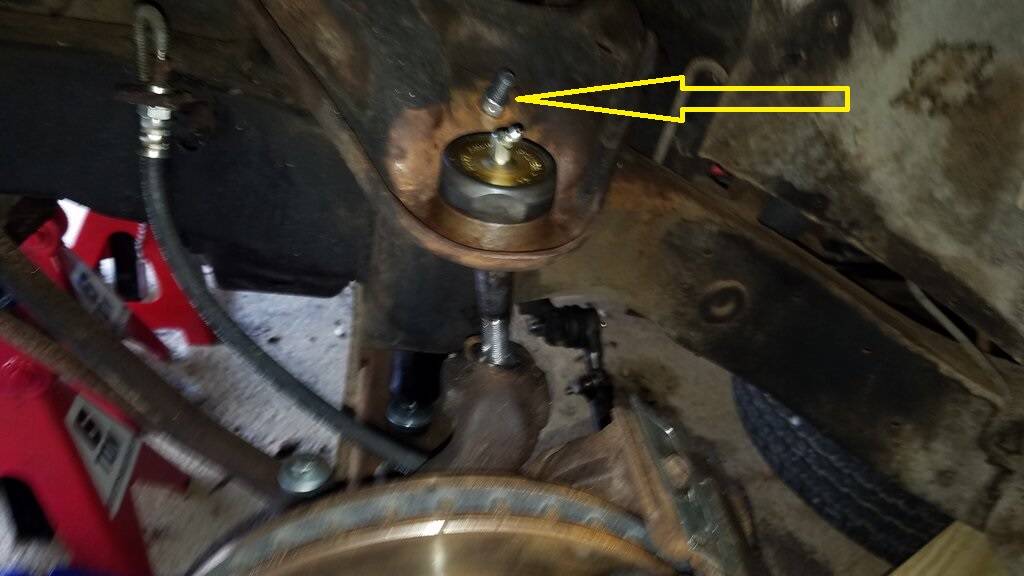

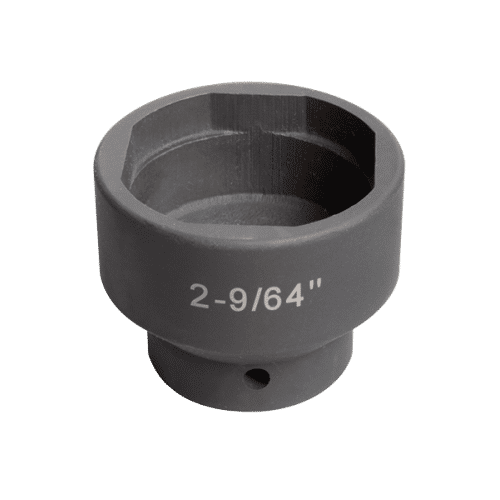

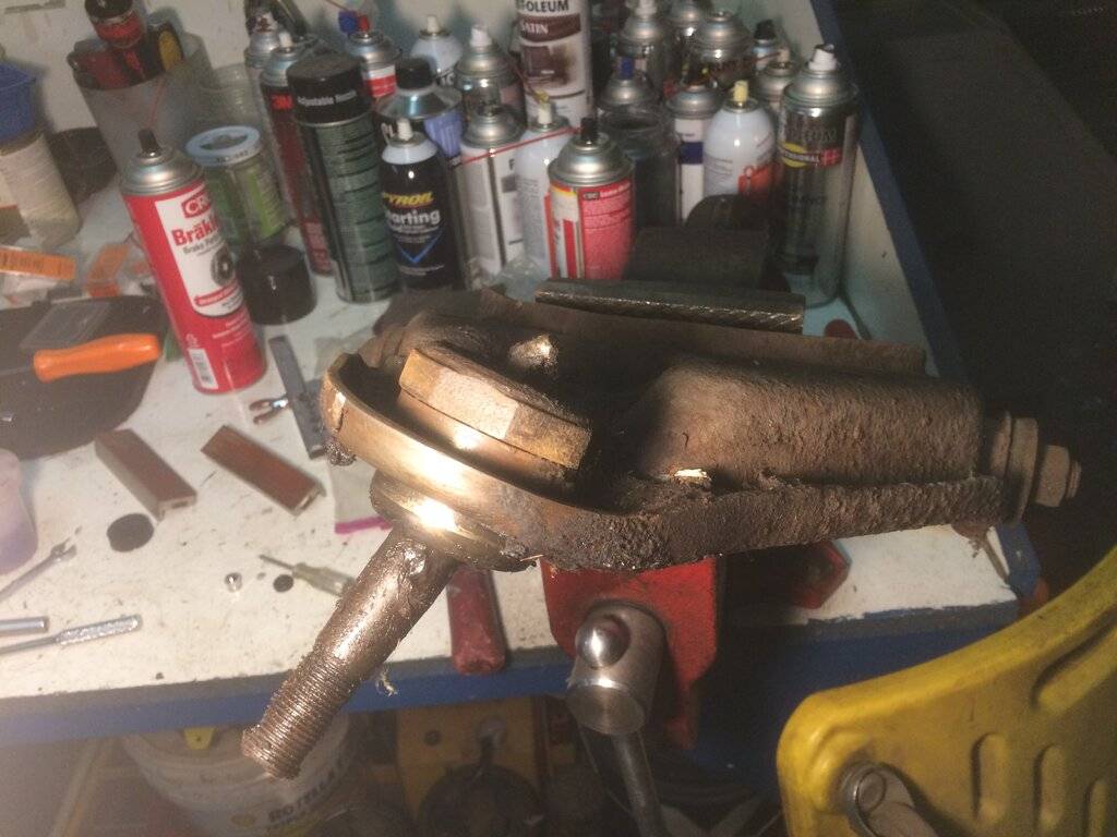

You've still got to address the upper ball joint anyway... Buy the right socket and see if it tightens (I bet it won't) and either replace the UCA or a couple welds to hold the new one in place.
