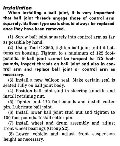

I'm assuming the instructions for '65 won't be any different vs '67:
