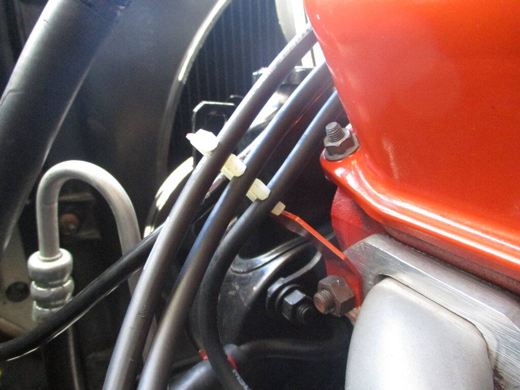

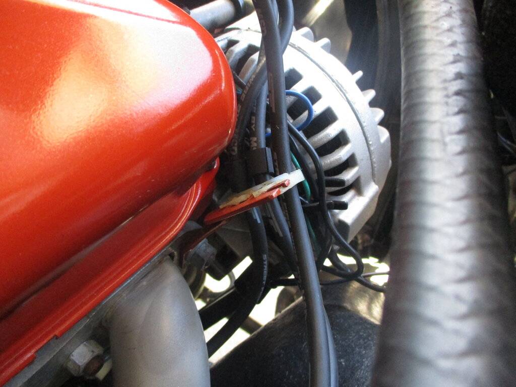

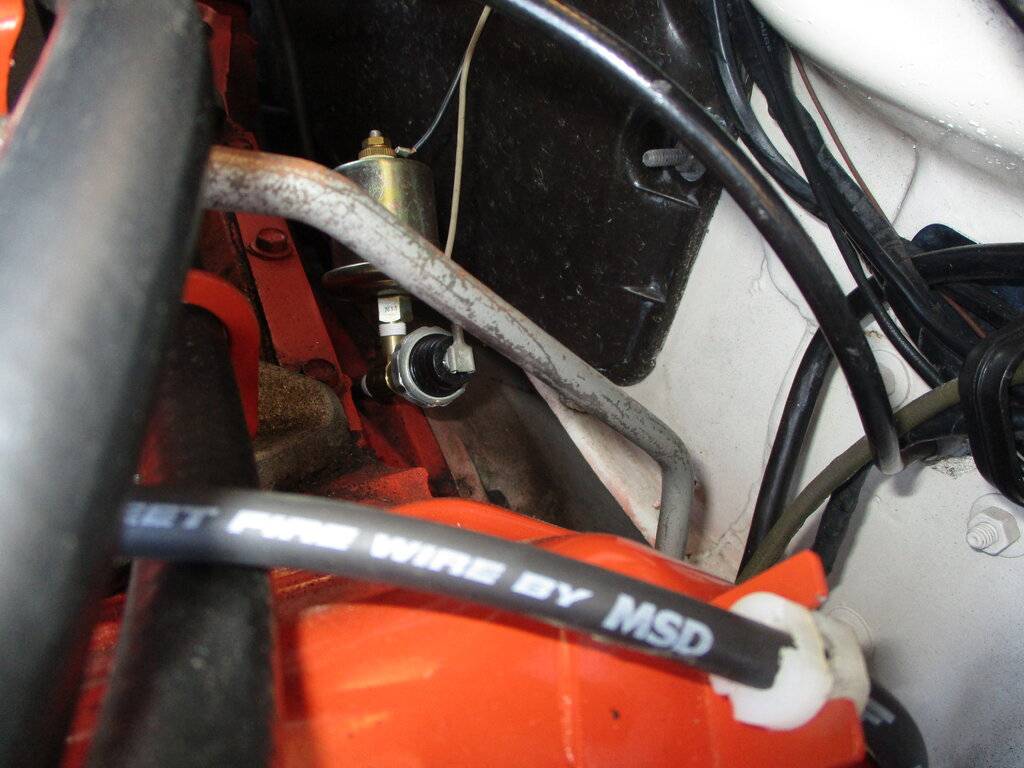

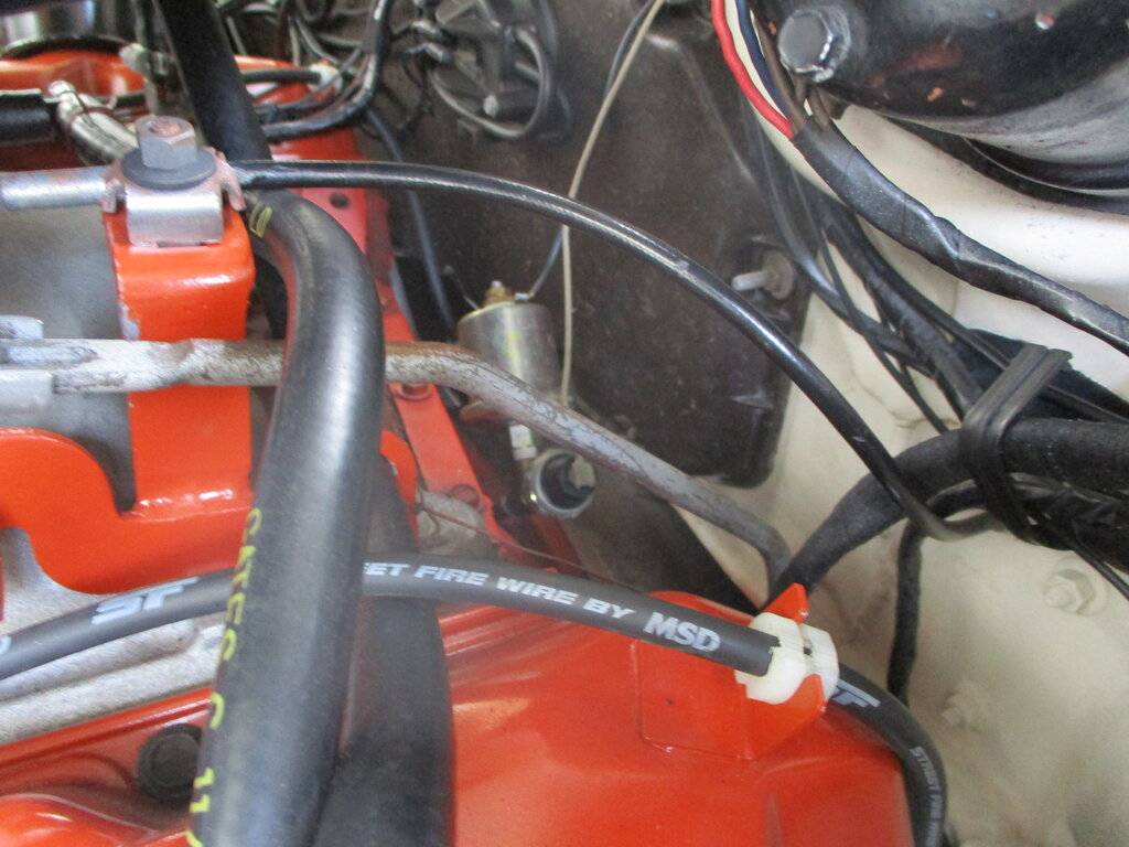

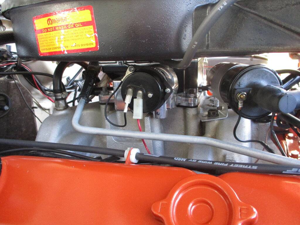

I used 8mm MSD wires. The trick is to drill out the insulators with a 21/64th bit. This must be done slowly and gently, or the bit will grab that nylon. I did this to both the single round and the loom style insulators. This must be done for the single wire metal support on some BB valve covers. Drill it out (Dremel) and add new black insulation by using several layers of Liquid Electrical Tape (Home Depot).
I also cut down the four-wire loom to three wires, as I never liked that "missing wire" look from the factory for some BB engines that feed the two rear plugs along the valve cover.
Example of "missing wire" OEM loom:
I don't know why these pics repeated....I'll ask Al Gore.
