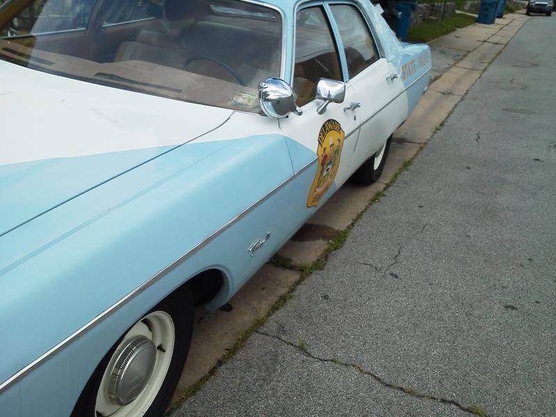

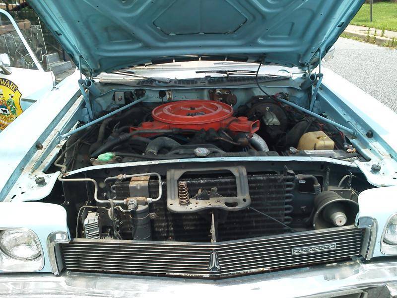

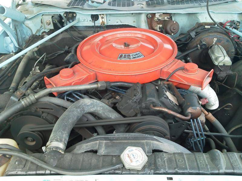

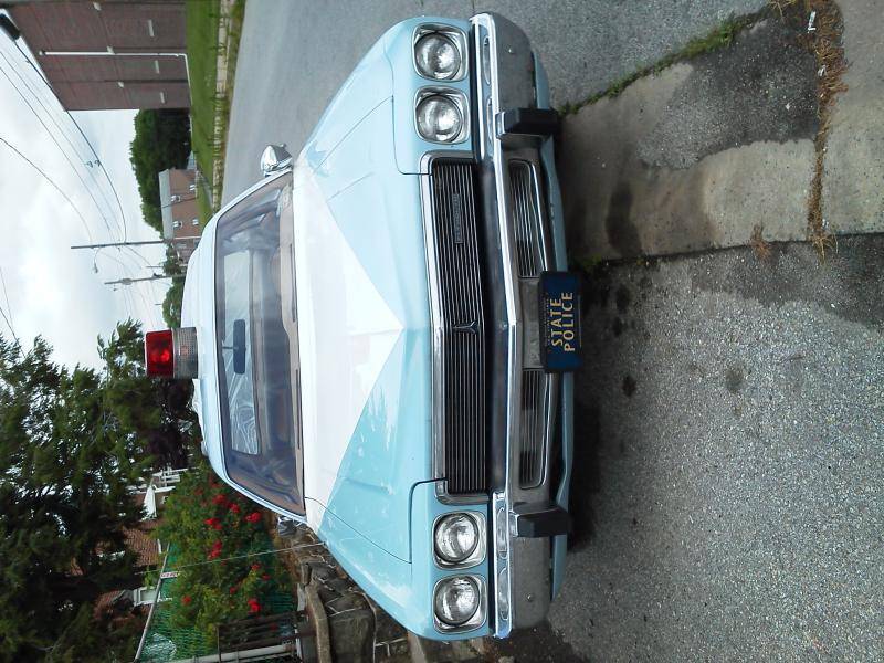

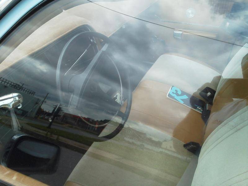

Here is the car, I will get pictures of the water damage once grandpa takes his make shift cover off the back.

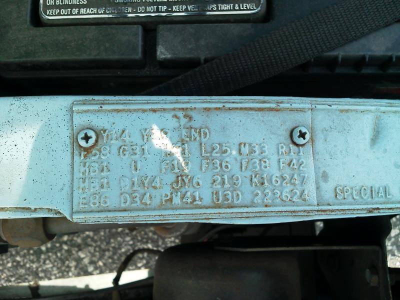

Please check the speedometer to see if it says "CERTIFIED" on it.
Also a photo of the Data Plate on the radiator support would be awesome.

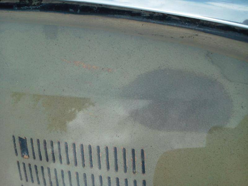

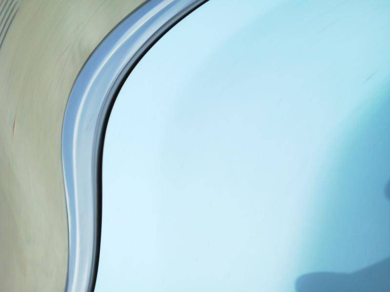

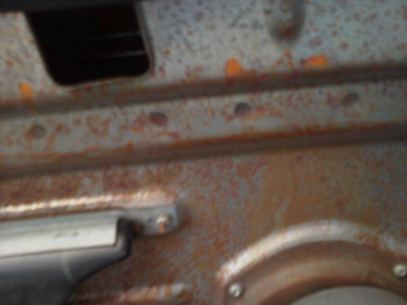

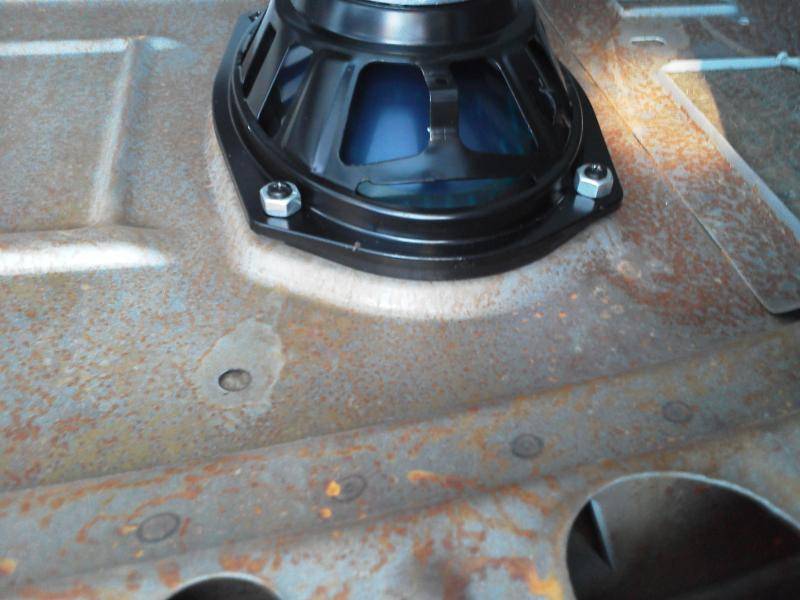

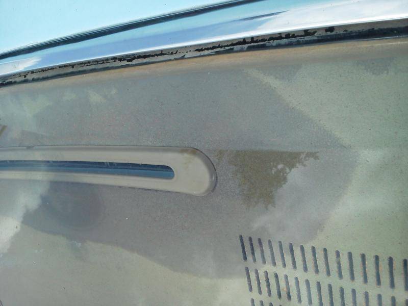

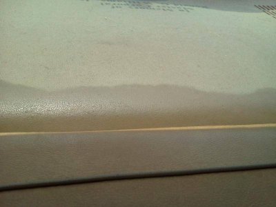

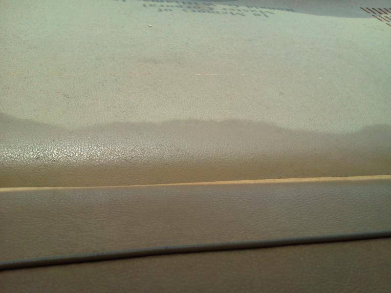

Now I just need to figure out how to stop the water from ruining this beauty. I want to do it right, just do not know much about cars. I'd feel terrible just plugging it up with some epoxy but it may be my only hope to keeping it from rusting out.
First, let's keep her inside. Second, pull the back glass and have a look ...... I'm betting she's still real good with one problem area
I think you're probably ok and the damage isnt that bad at all. I'm just seeing light surface rust on bare metal and more vinyl discoloration from sun than water damage. Hard to tell for sure though.
You gotta get her under a roof and get the glass out and dash and package tray out. Do it!!! before it gets bad!
attachment.php
is that rot holes along the edge or paint flaking off the seal?
