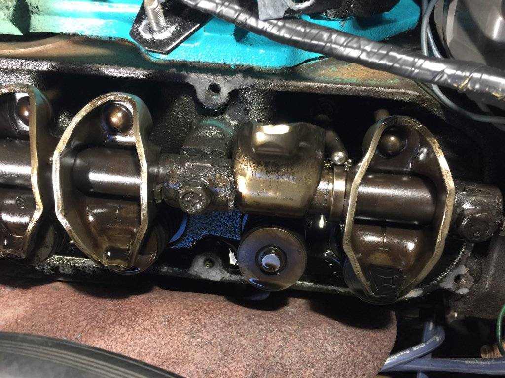

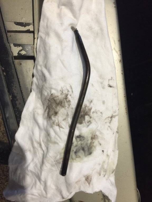

Well I finally tore into it and I found the culprit. The spring is not compressed. The rocker doesn’t look bent in any way.
I hope the valve didn’t touch the piston.

Check to be sure the lifter is still in place. Bent push rods are usually caused by a valve that has a rusted up stem and that causes excessive strain on the push rod and it bends. It looks like you are getting plenty of oil to the top end, so I doubt oiling is an issue. Did this car sit for a long time? Remove the rocker shafts and check the rest of the push rods to be sure that none of the rest of them are bent. You can probably just replace the damaged unit if the rest of them are ok. The push rod was probably bent for some time before it gave way and jumped out of the rocker or the lifter. Once they are bent they tend to keep bending until they fail. Replace the damaged unit and turn the engine over by hand to be sure the valve is opening and closing freely. If the valve appears to be operating normally, run a compression check. If the valve got clobbered by a piston it usually will also be bent and you will have little or no compression on that cylinder. In that case, you are headed for a valve job.

Thanks Dave, the owner before me had the car for a year he said he put less than 1K miles on it. I’ve only had the car a few months. Not sure of the history of how much it was run past the previous owner. Thanks for the reply, I appreciate it
Flat cam lobe will cause the same issue...I'd grab one of the good pushrods and drop it into the lifter where the carnage occurred and rotate the engine and see if there is any lobe left there before I bothered ordering any parts. If the cam is wiped, all the "glitter" has gone through the engine. Glitter is bad, it usually wipes all the bearings sooner than later.
I might have some of those pushrods, you won’t find them in the aftermarket and you are going to need one if you’re not replacing your lifters.
Straighten it out and shove it back in. You will not find them in the aftermarket as mentioned. If there is a problem it will bend again.
