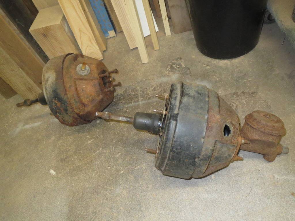

These are from ‘64 with drums.
A brake booster. For a '66 Imp, I don't know what the original looks like
If you called booster Dewey today you could probably buy the extra core I sent them(1 of the 2 pictured).

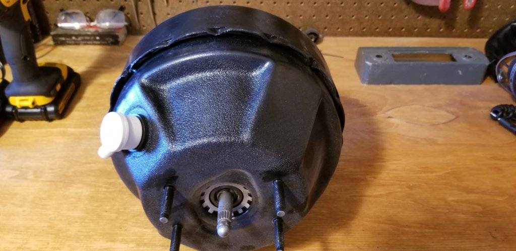

I've got this one waiting to go on my 70, not sure what its bolt measurements are, could check tonight when I'm home.
