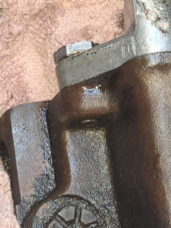

Just cleaned it up and ran it at idle, in park. As you can see from picture, it's weeping out behind the bolt, between the flange and housing. What do we have in between O rings? Gasket?.
2 o-rings behind that bolt on aluminum housing.
the steel housing with the 2 bolts facing straight up are the ones to adjust the steering centering. Leave this alone for now.
napa sells power steering fluid That’s fine for old cara.
what he said, the o rings are probably leaking and need replaced

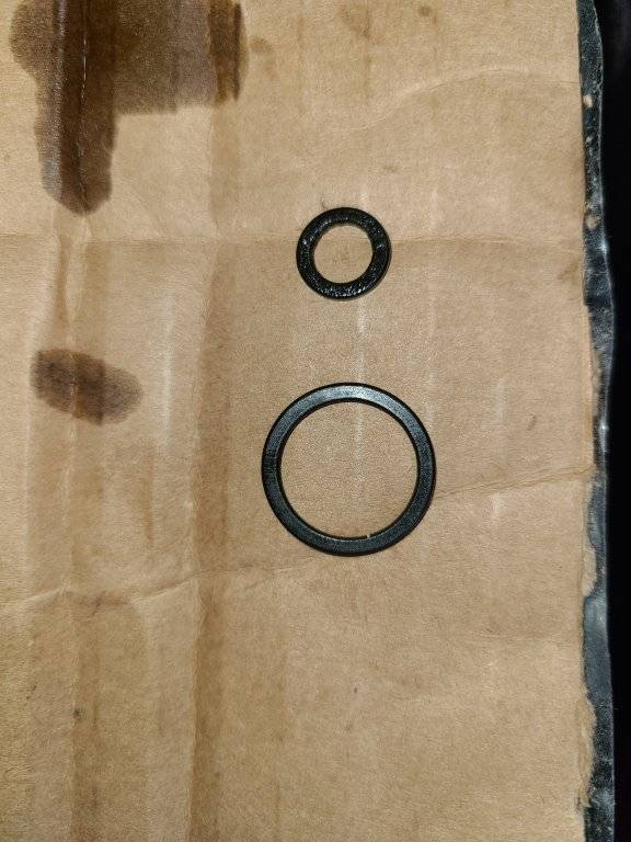

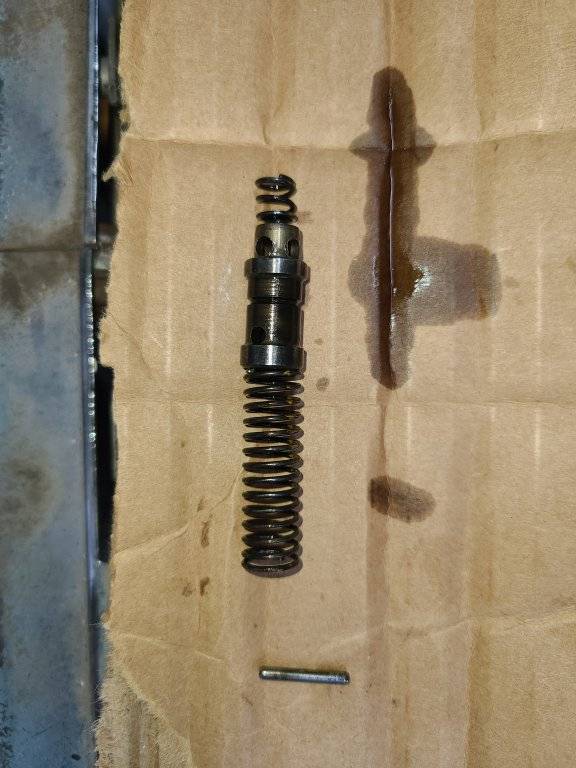

Got it apart, 0 rings look kinda flat, are they supposed to be round? Also picture of the order springs and valve came out of housing, does it look correct? Thanks all
Edelmann 8518 should be the seals for that piece (and the one you're better off not touching)...rockauto, ebay, amazon...seals a couple bucks shipping probably lots more
Thanks, I'll take a look at those places, right about shipping, could just put them in a first class envelope for price of a stamp
Thanks for the kit number, 0 rings stopped the leak, took it for a long ride, stayed nice and dry. Then I had a blast of hot oil hit my leg, damn oil pressure line came off the gauge. At least that was a easy fix
