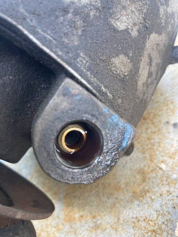

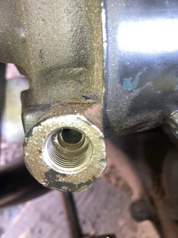

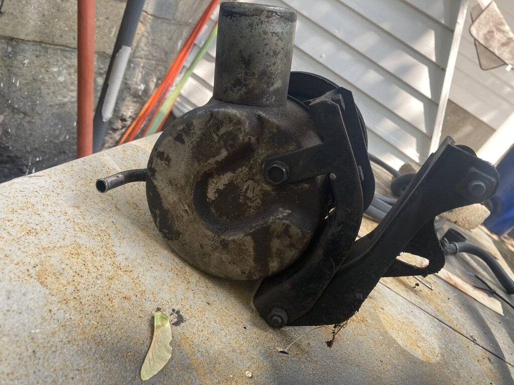

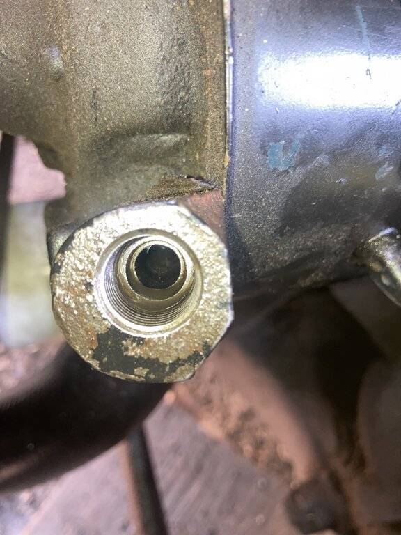

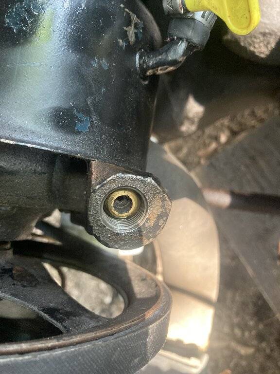

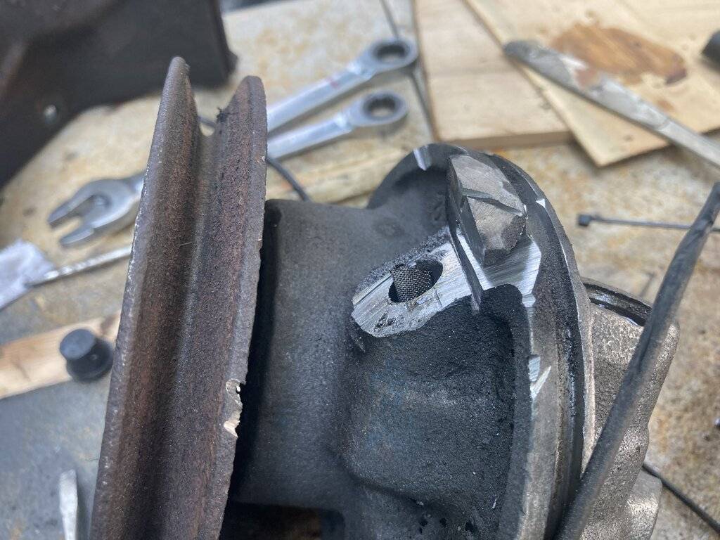

Hi everyone! I’ve got an old seized TRW pump that I’m replacing with a 69-73 Federal pump that I have lying around. The TRW high pressure port has an inverted flare fitting in the pump body whereas the Federal appears to have something else. Can anyone tell me what kind of fitting or adapter I may need for the Federal? Thanks!

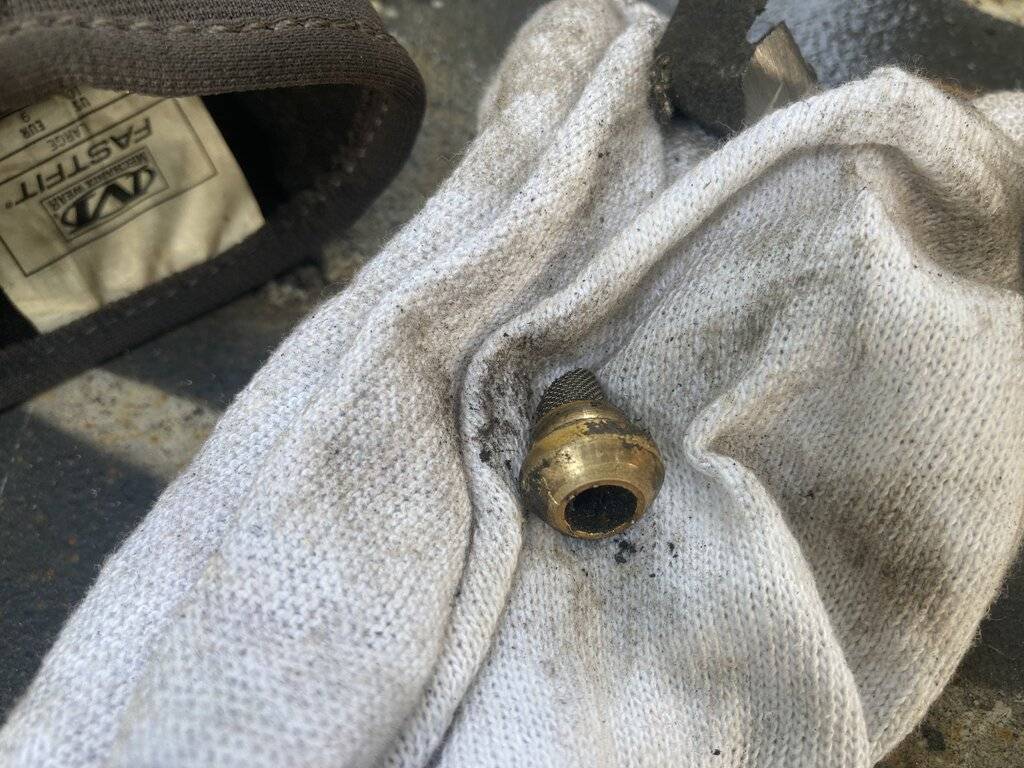

Well I couldn’t find a hose with the correct fittings on both ends, couldn’t find an adapter, local hose place couldn’t make me one. What to do? Well, the TRW has the brass fitting in it and I have an angle grinder……. Ten minutes later, power steering!
