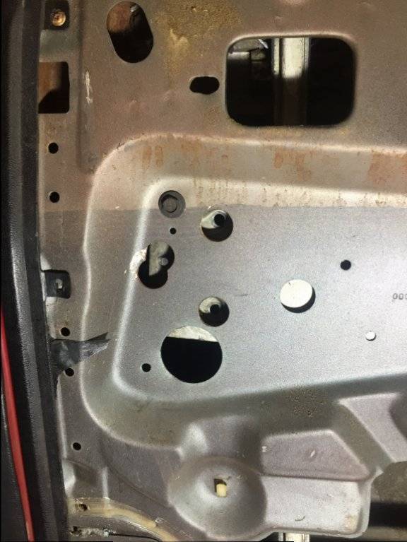

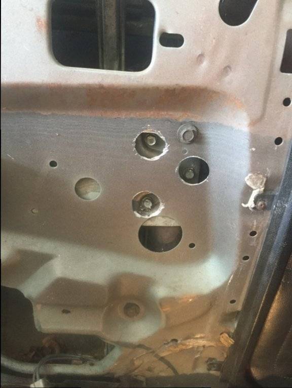

Ok so on the passenger side it appears there were holes already cut by a previous owner to access the motor bolts. This made removal and rebuild extremely easy.

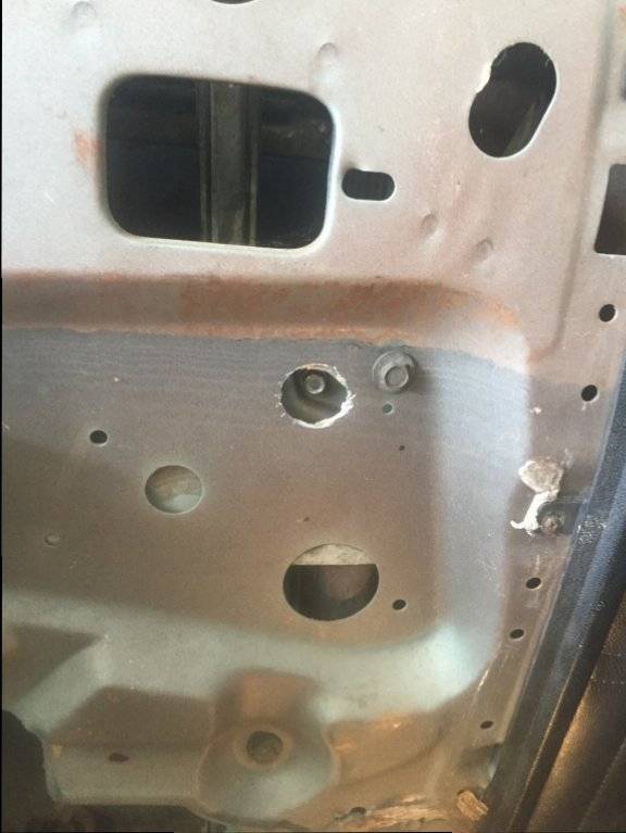

On the opposite side the holes were not cut. Therefore I made a template and used a hole saw to cut them.

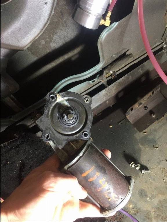

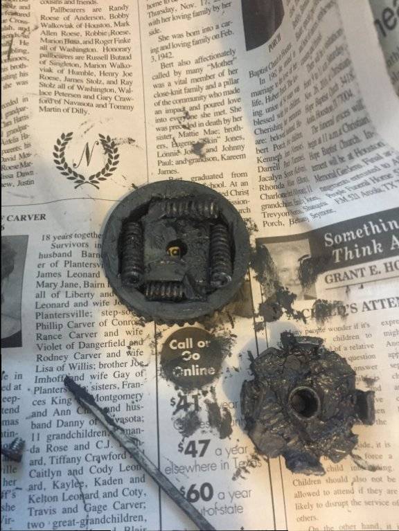

The power motor was different than the other though. It has springs in it and not the plastic pucks... anybody know about this type?

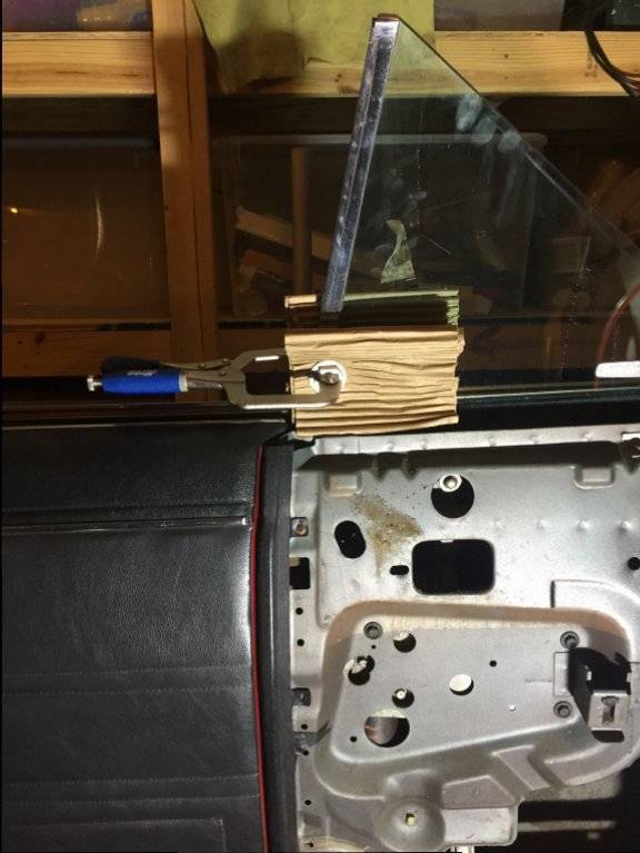

Then I cmlamped the regulator for safety reasons.

The 3 plastic round things in the gear was shot so I replaced them with new rubber. I Dont know if it will last, but it was VERY cheap. Its expensive to buy a new gearset here in sweden.
