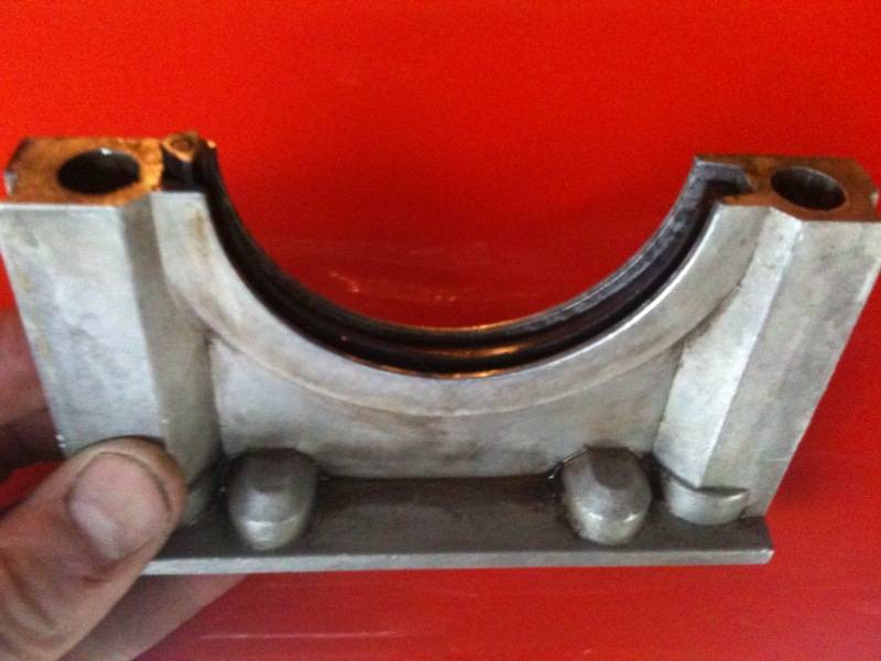

If I can jump in here...my 440 has the same issue. You don't have to pull the main cap to replace the rear main seal? Is the seal held in by the pan only? If that's the case, I'm absolutely leaving the motor where it is when I replace it.
The big block rear seal is held in by an aluminum retainer that looks like this. Small block is held in by rear main cap.
Consult your FSM for more info.
