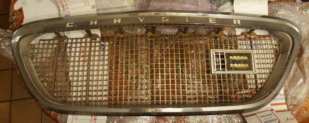

Sourced this out of New Hampshire to replace the broken one that was on my car.
Hard to find a 61 without it being broken in a corner.
62's are a dime a dozen. Will fit, but doesn't have the word CHRYSLER in the grille.

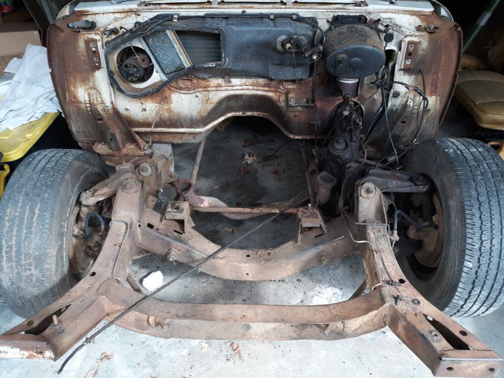

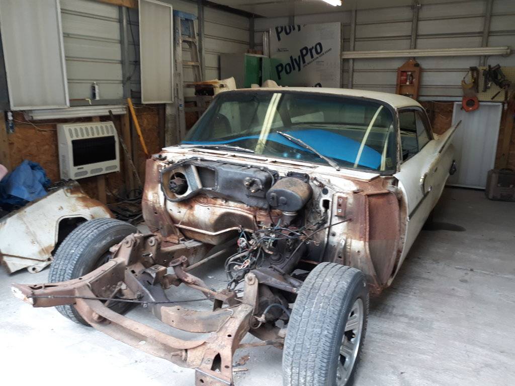

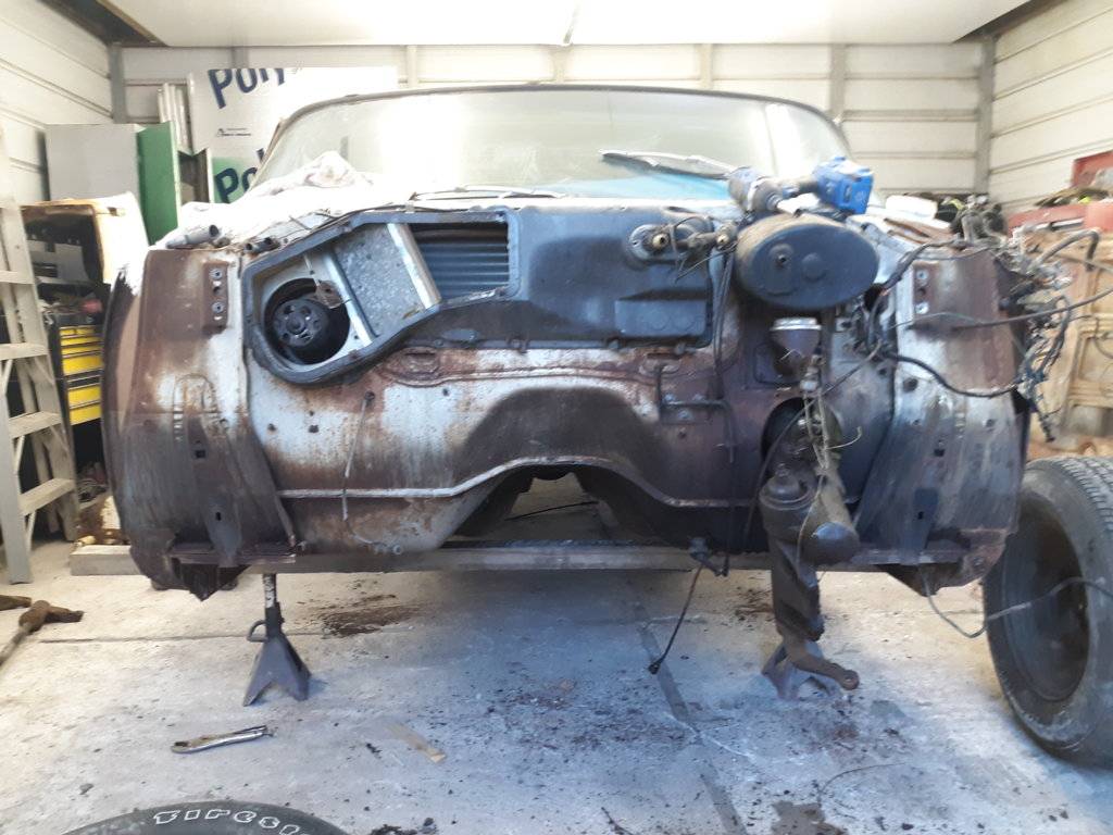

Now the subframe comes out, then dissasembled. Taking it to a chemical stripper to degrease and derust it. Then dipped in Ecoat to keep it from rusting inside and out again.

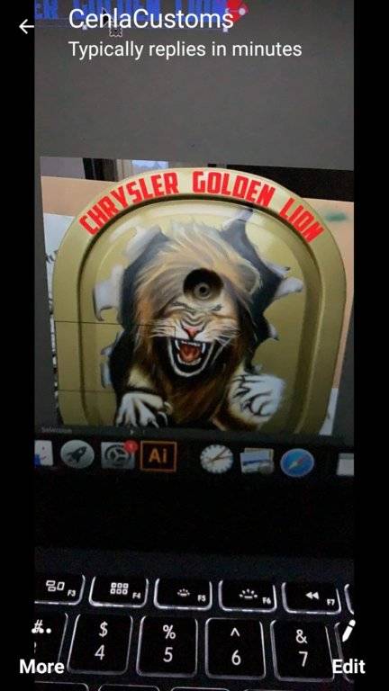

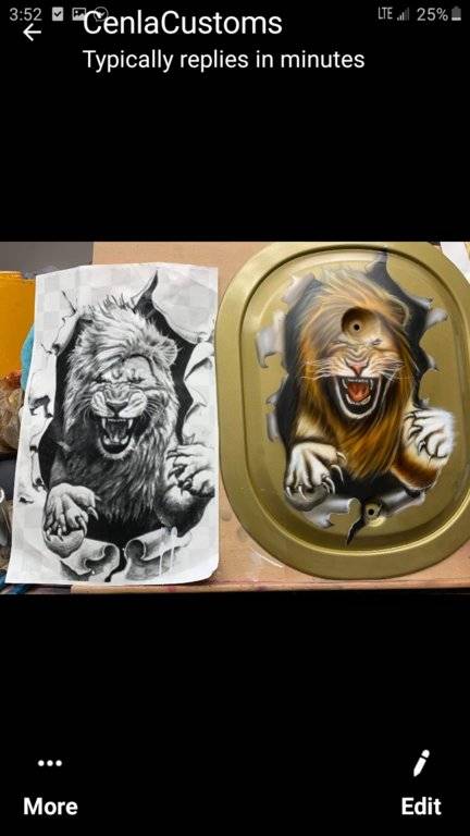

Mock up of the lettering, done in the same red as the valve cover decal.
This is a computer rendering of the lettering. I asked for more space between the words and other picture is the modification.
Letter spacing will be better when painted.
Subframe is out. Taking it to be dipped to get rid of grease and rust.
Then ecoated to keep it from rusting inside the frame again.
