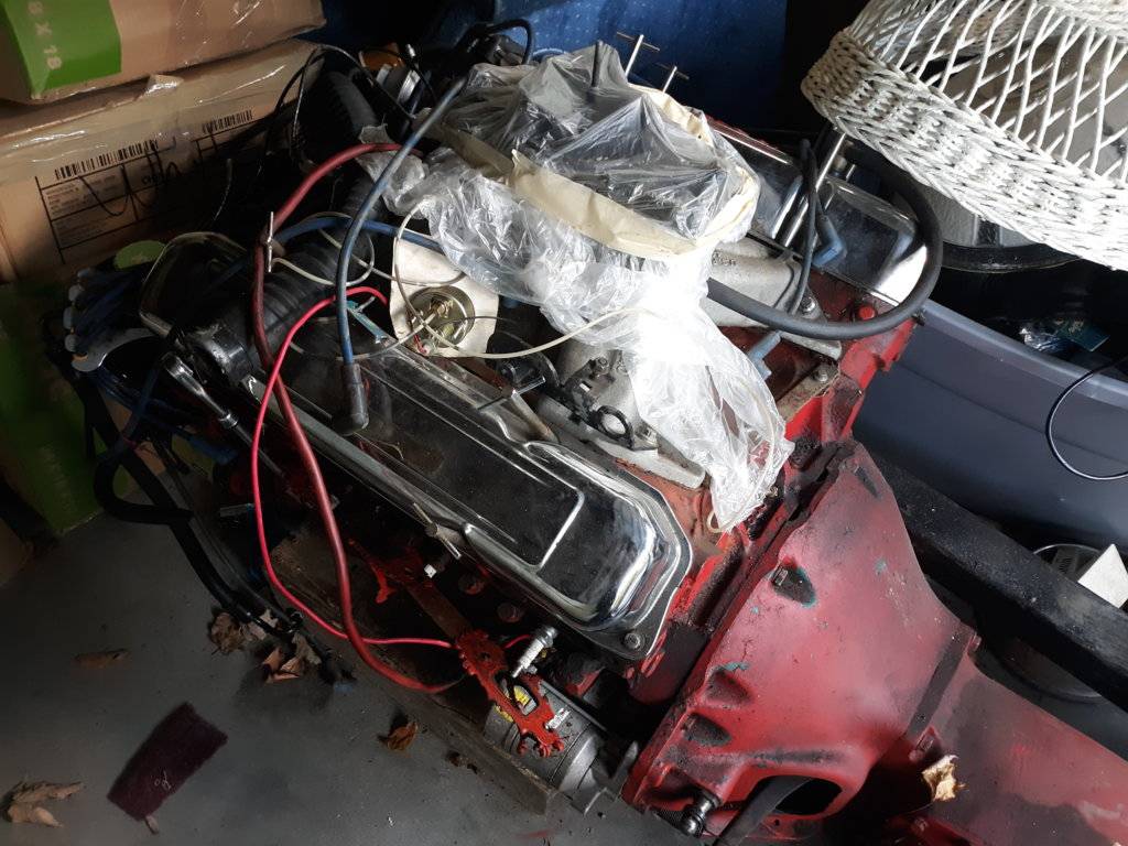

Going with a 440, but claiming 413. Motor is 1971. Carberation is a 69 six pack set up. It's already all rebuilt and ready to go, if I ever get the engine bay prepped and the motor in.
Have test fired the 440 in the donor car with the 4 barrel carb. Ran great.

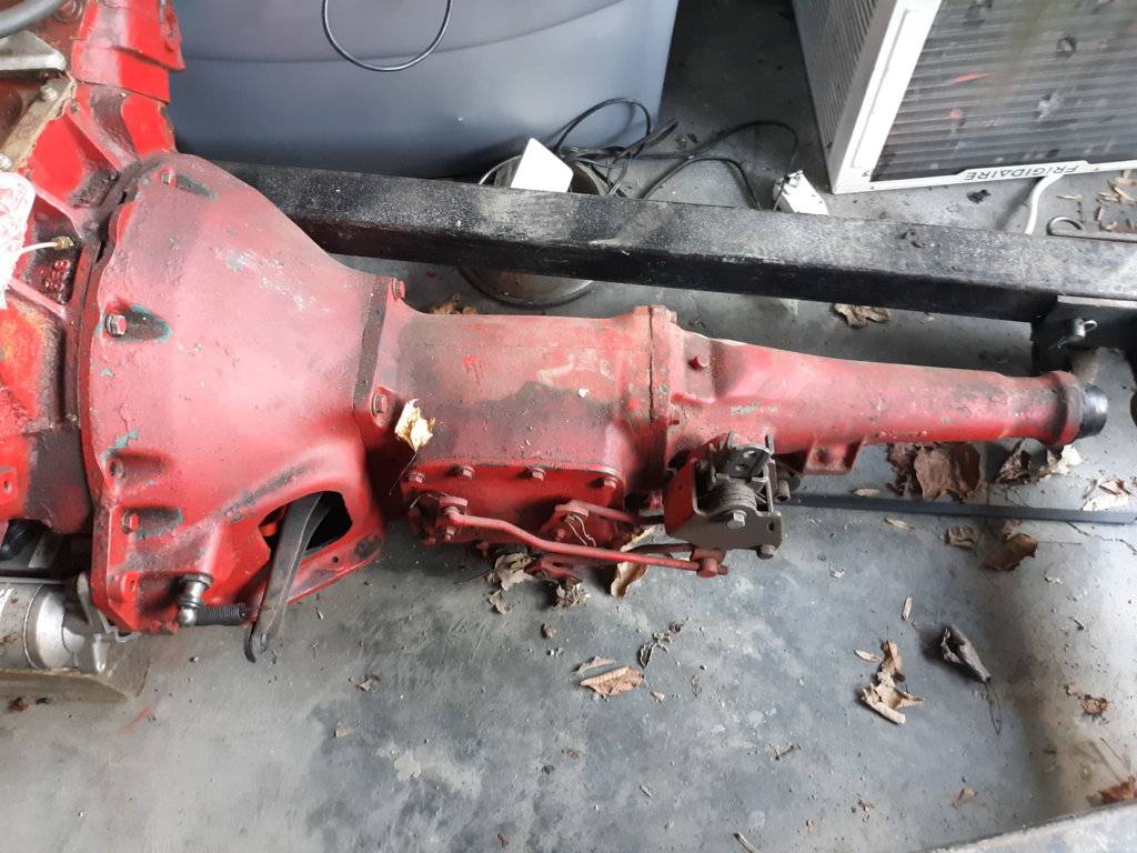

Also pulling the pushbutton 727 and installing an A833 4 speed tranny.

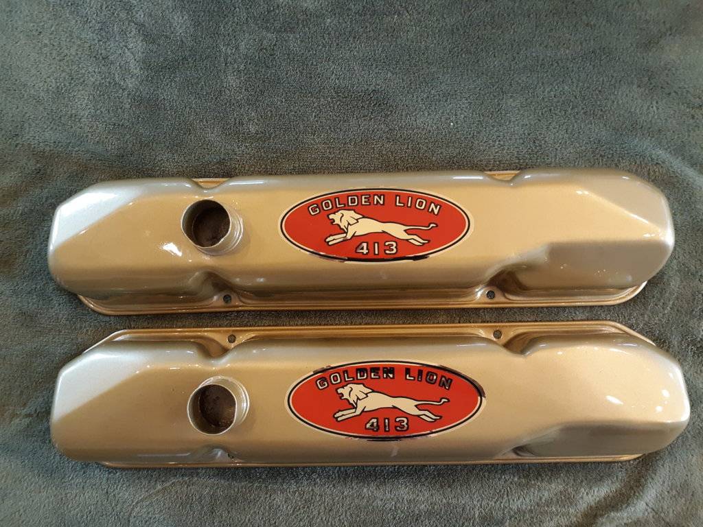

Painted the valve covers in original gold colors and applied new 413 Golden Lion decals.

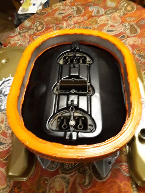

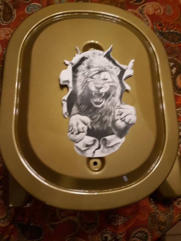

Painted the six pack air cleaner lid and shipped it off to an airbrush artist in Louisiana to paint the lion on top of it. I've enclosed a picture of the design, but its in black and white. He will do it in color and make it larger than I could with my printer.
It will also have the words CHRYSLER GOLDEN LION at the top and 413 SIX PACK at the bottom of the lip around the edge. The lettering will be red to match the red on the valve cover decals.
Aluminum factory 6 pack intake manifold, has been powder coated in Aluminum.

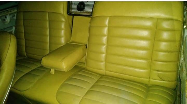

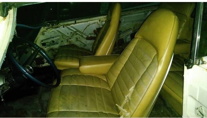

Scored a cool interior from a 73 New Yorker. It has the front buckets with buddy seat. The backseat has the fold down arm rest in the center. Drivers seat is six way power. Have all the seat and shoulder belts with hardware to .

By the way, if those valve covers only have 4 holes, you're going to have an interesting time installing them on 6 hole 440 heads.
Good eye....I think those are only 4 hole valve covers, you can see the ends of them in the pic of the six pack carb and air cleaner and I can't make out any bolt holes. :(
Thanks. I had the same on my '62 413. Always wanted to put custom covers on, but none came in that style.
Well, thanks for the education!
Now in search of 440 valve covers. Painted these before I bought the 440. Have a low mileage 413 in the garage from a 59 Imperial that I was going to use. then found this motor and tranny combination and decided to go this route instead.
Didn't realize until tonight that there was a difference.

One thing I still don't know yet, is if that 6 pack air cleaner will clear the A/C /heater box on the firewall of my Newport without modification.

The vacuum pump is electric and does not need a belt etc. The later 6BBL and 6Pack cars were not offered with A/C because the air cleaner would not clear the compressor.

The impending issue is the plastic box on the firewall. Wondering if that will clear. Haven't had time to investigate that yet.
