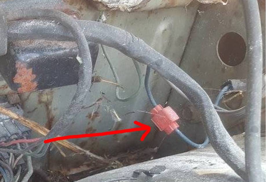

"unmolested" Seriously? Who's the lazy SOB that tapped into the Ballast Resistor feed?
That part of the washer pump stupidness?

ya some P.O. rigged up that washer pump on the fenderwell, and the orig. washer fluid tank with broken pump was just bypassed...go figure. i dont think bruce did it but the P.O. before that. maybe B will comment.

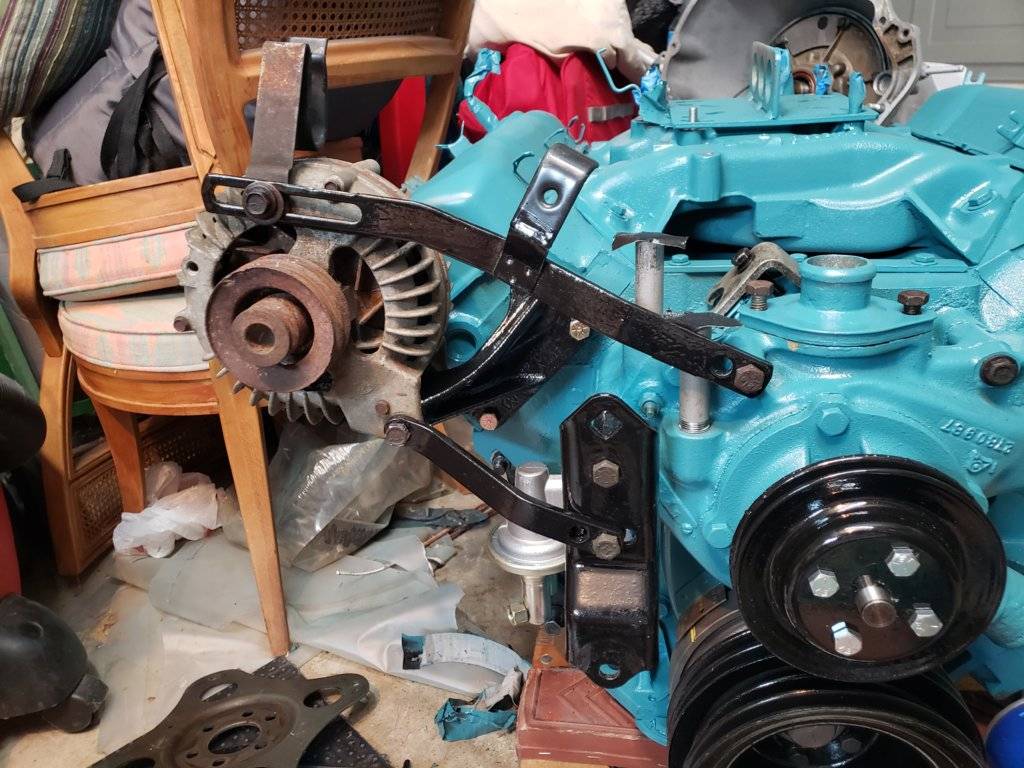

so does this alternator mounting apparatus look all
correctly installed? I know its the old alt still ,but im just hanging stuff to make sure I have it all and how it fits etc.
o I wanted to add some notes for the next guy - this is a 1968 440 A/C p/s engine. the idler bracket is gold. herbs has a kit for the whole tamale for 2 hundy. Herb's Parts - Mopar Restoration and Performance
the dual-spacer thingy - on the one I removed, one of the holes is offset so the piece is directional. it liked it with the casting part #s facing inside/facing the water pump - it lined up way better in that orientation.

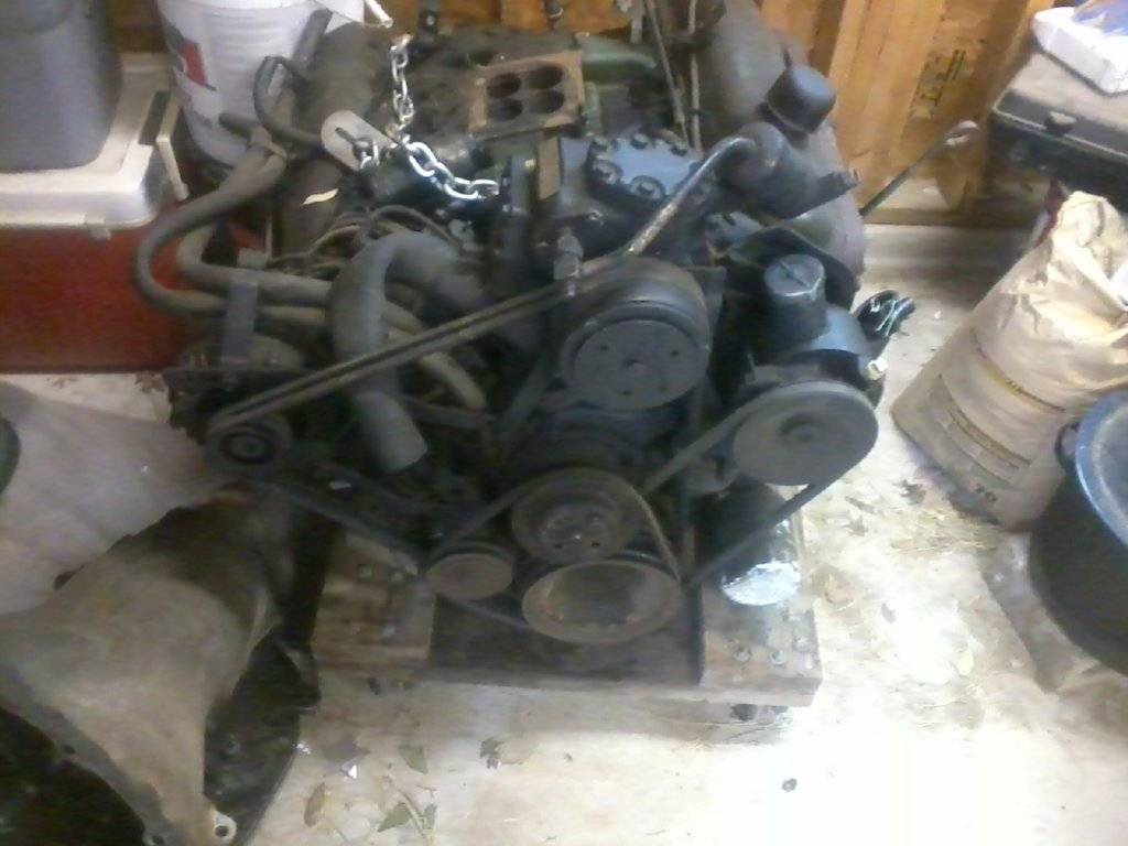

whew I switched phones,, but found a couple of pics:
adding extra pics for documentation, and thx for the above pic J ^^

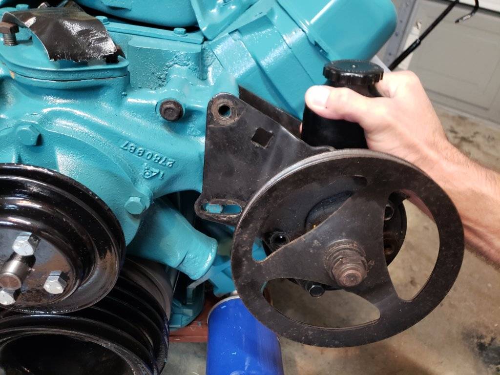

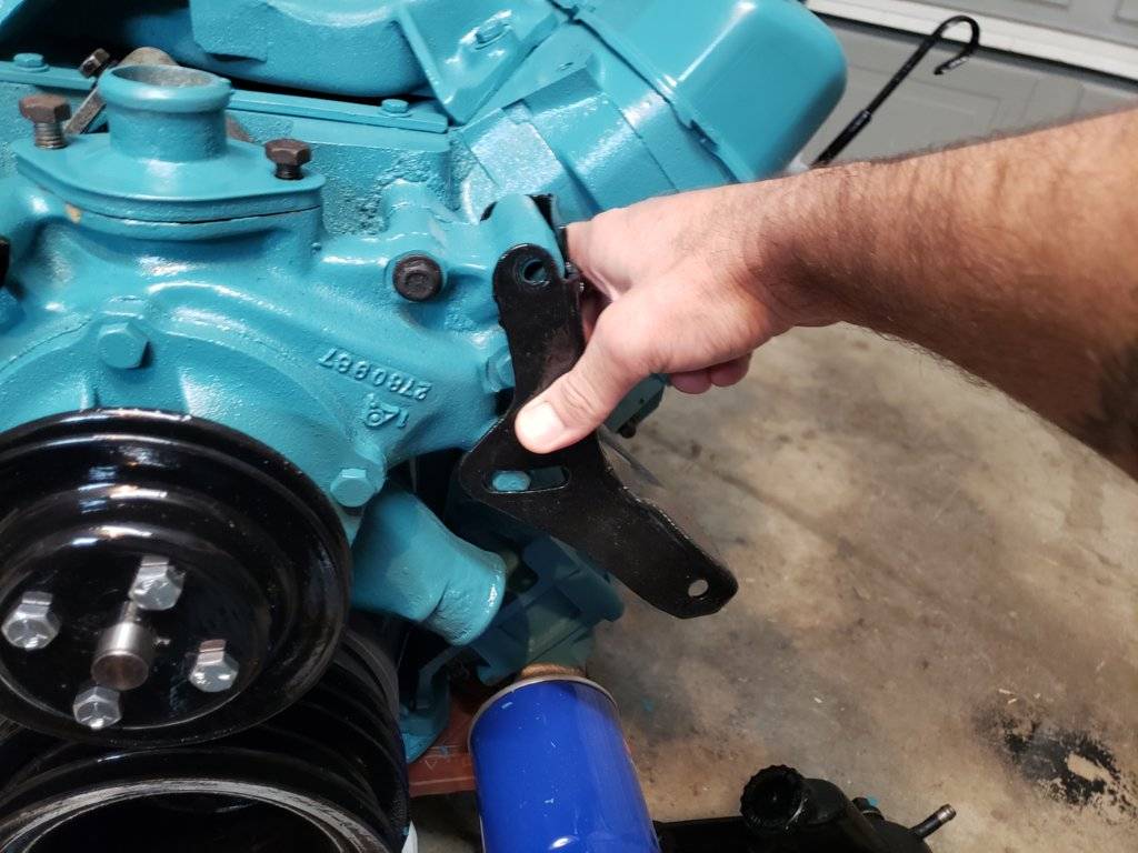

fitting parts back onto this block, and trying to figure out the power steering hangers.
I think I need a pic of a 1960-1968 440 motor w/AC w/PS from the driver side and maybe I can figure out whats doin.
but - everything im looking up says this is a 1969 pump and bracket I have here (see pic).
when I got the car, the PS ***'y was not on the car, so I have no idea what its supposed to be like.
other than needin a couple of 3 5/8" bolts, im not sure what else is missing.
any advice is most welcome.

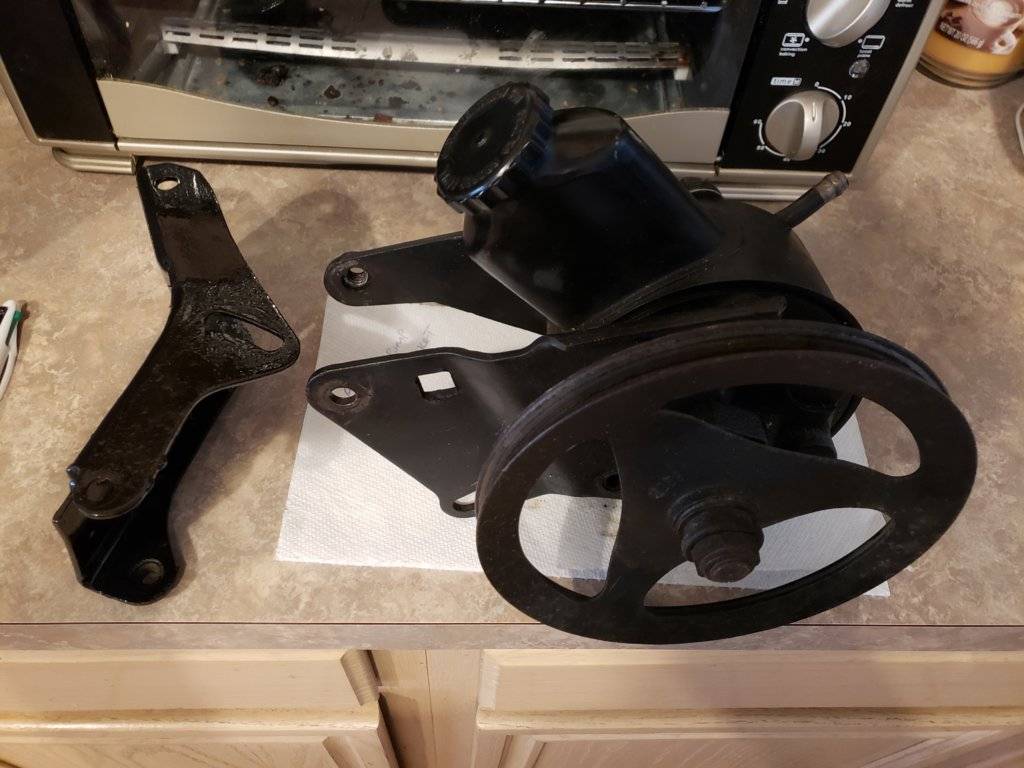

after looking at this all day long, and reading the FSM (worthless) and the parts catalog (less worthless, but still no answer) and surfing the interwebs of mopar 440 motors pictures, im coming to the idea that these 2 parts don't go together.

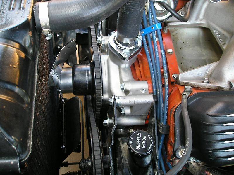

it looks like the pump fits right here ^^ without the piece shown in pic #1.
and piece #1 and #2 don't fit together nicely that I can see, they collide when you try to marry them.

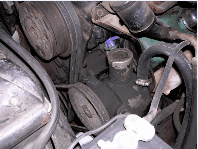

Go for it but since "the PS ***'y was not on the car, so I have no idea what its supposed to be like" and Polara_500 pic shows the other pump. (can't really see the brackets to well with all the grease/road grunge)
The main thing you need to be concerned with is it being a A/C (right?) car and the pulley alignment as in past discussions here with the water pumps thread, A/C or no A/C are different brackets? (correct me if I'm wrong).

it looks like I have the same PS pump as what you posted over on b-bodies - pulley wheel is almost 7" wide. the only v-belts ive seen listed say 4 5/8" or 5 1/4" dia... any idea on what v-belt this thing needs?

here is someone elses work on what they had to do. so it looks like i have the bracket for a TRW pump, and the ***'y is a Saginaw, so they do not go together as far as I have found so far.
Is it the pic angle or do I detect a little mis-alignment with the pulleys?.
ALT belt looks OK and straight. PS appears to be off.
