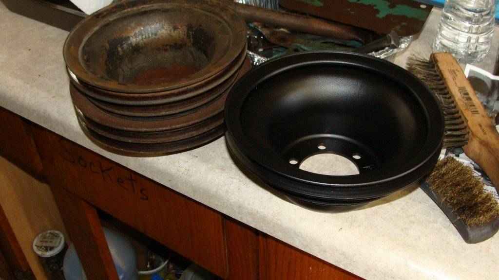

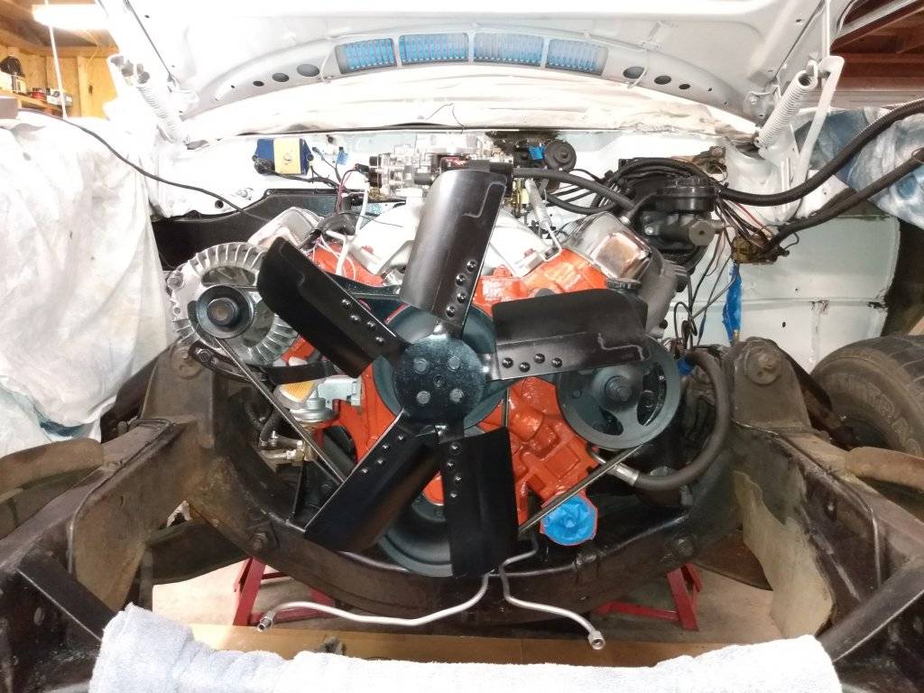

I did the same. One of the things I remembered about switching from the triple to the double pulley was that I went through quite a hassle finding the right one so the geometry worked. One of the issues was that my friend who has built 40 years of mopars said to me, go look in that milk crate in the corner, and it had about 30 different pulleys in it. Through trial and error we found the right one, and he handed it to me to media blast and paint. The belts would not fit because the grooves in that pulley were V shaped instead of U shaped?? Or the other way around? The belts just didn't seat properly and on start up sounded like a tribe of banshees. Wish I had documented it more clearly, so I could be of assistance. I can take pics if you like, but not sure they will help.

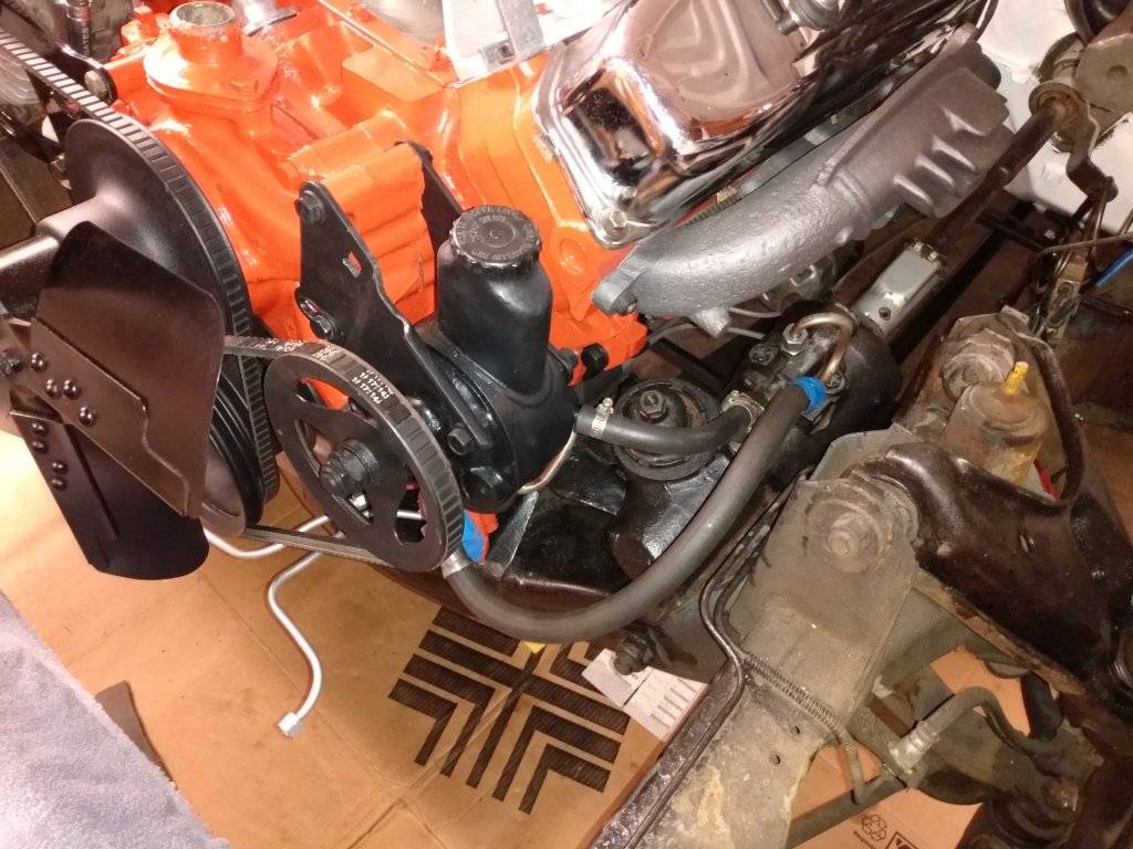

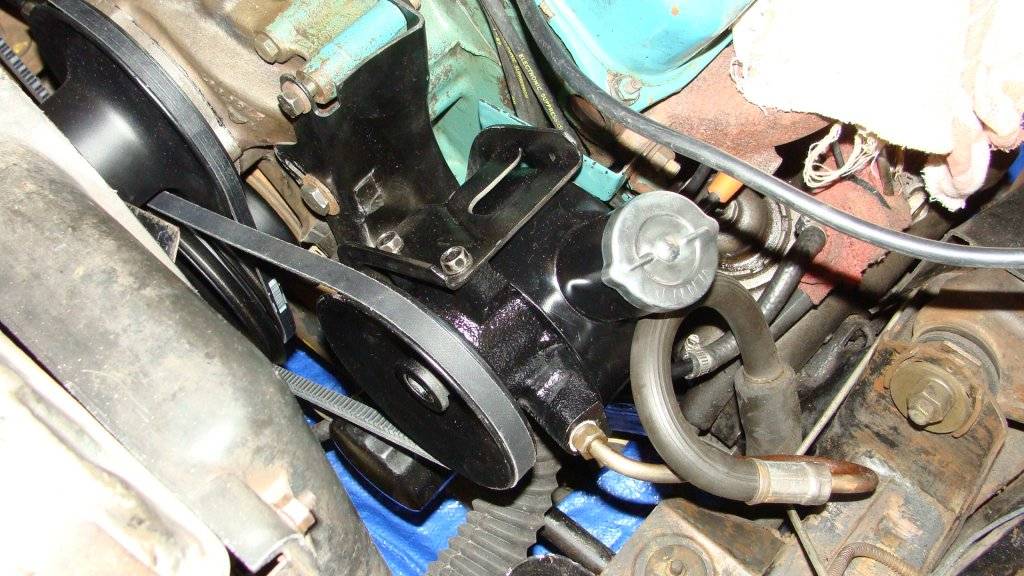

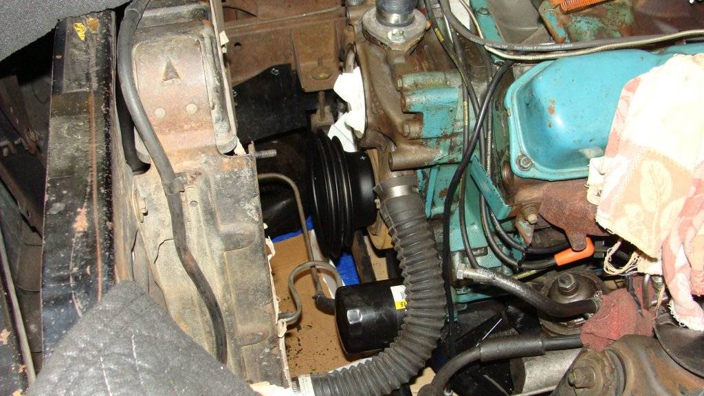

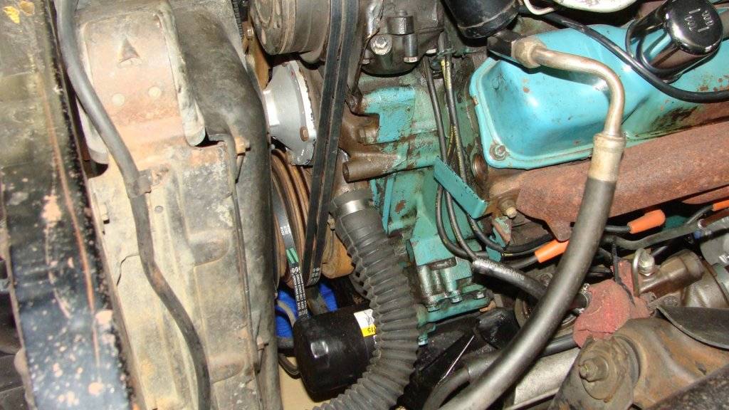

Ok, I see the issue after I installed everything. The PS belt hits the water pump pulley underneath, The remedy was a smaller belt 3/8 wide rather than the standard 1/2 so the belt sits lower in the pulley. I had ask the seller of the pulley kit 68 NEW YORKER, oh well, we'll see how it functions once the weather breaks and I can back out of the garage.

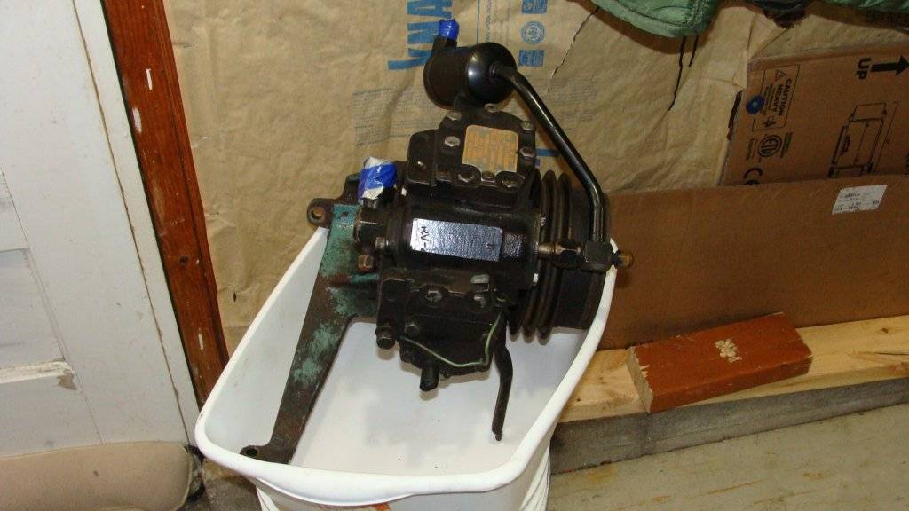

after driving the car and getting to much noise, I put the ac compressor back on. LOL, and now I'll be taking it back off so I can change timing chain, oh well, I'm retired and can only walk the dog so much
