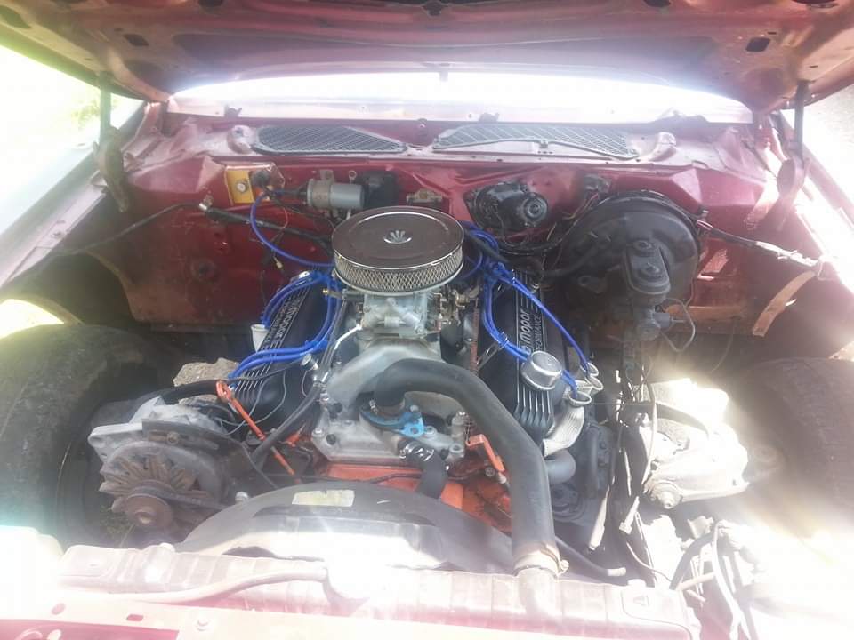

    You could always put a hot 340 in it with an 8.75 and 3.91 Sure grip...then you will have a completely different car!
    My old 79.
    • Like Like x 1

    100 amp alt. No A/C?
    Is that your LeBaron parked next to it?
  12. 71Polara383
    71Polara383 Kid with ballcap
    Messages:
    2,833
    Likes Received:
    4626
    Joined:
    Dec 10, 2016
    Location:
    Rockford,IL
    Yes to both questions. I had a hell of a time getting the pulleys figured out...it wasnt right but it worked and I got it to stop tossing the belt at 6500RPM. No AC, No Power steering.
    I've always had M.M.D. (multiple mopar disorder)
    • Like Like x 2
