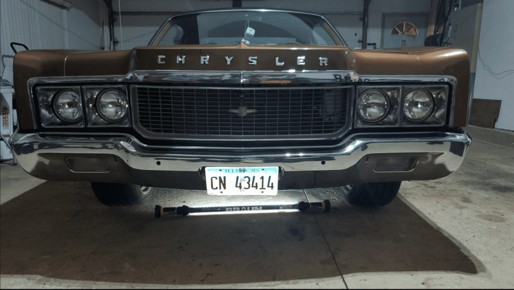

My question to the ones that are smarter then I is this. Could my issue actually be my drivers side torsion bar? If you look in the top picture you will see the Torsion Set Screws. The drivers side (right side in the pic) you can see its screwed in pretty far in order to get the car even. The second pic shows how even she is right now. Could that be my issue?

That was my point of this thread. Is my right side torsion bar bad as I have to really screw in that set screw in order for the car to be even. Thats why I showed 2 pictures, one of the current settings and one of the car being even. If I unscrew that screw, that side will drop down.

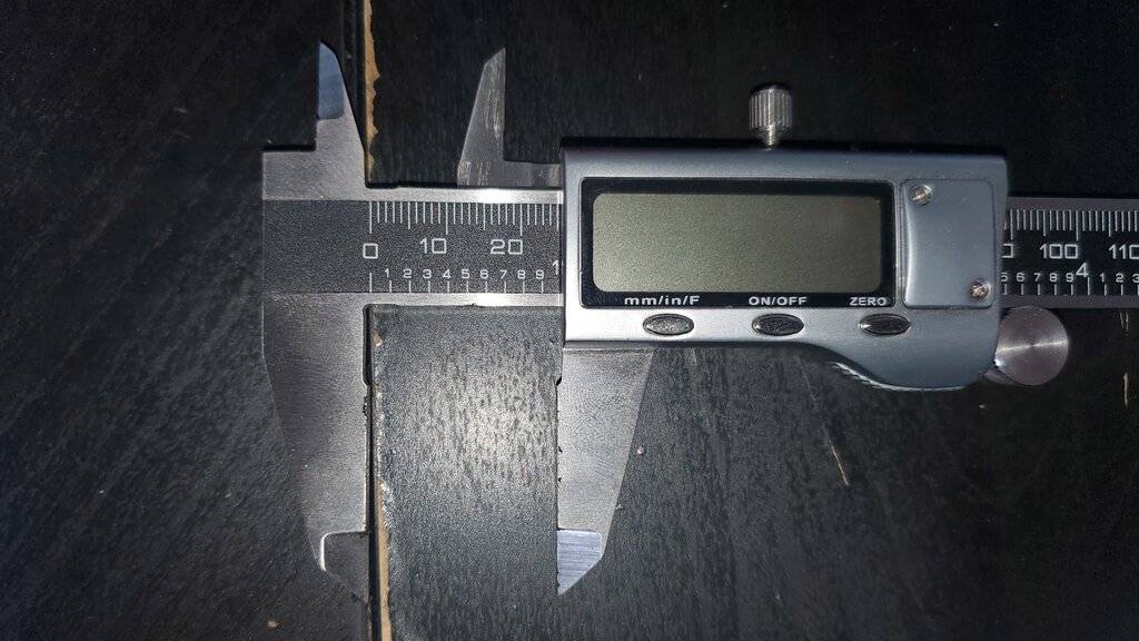

I see that one side is screwed in tighter, but can't tell how much from the picture. So how much of a difference side to side on the bolts? Also, do you know if both bars are original to the car? Or have they been replaced and are they matching bars? If you don't know the answer grab a set of calipers and measure the bars.

I have no idea if they have ever been changed or if they are original. I can tell that they are old for sure. My battery died in my caliper but none the less, they are both the same size, I took a pic of the caliper locked into the size.

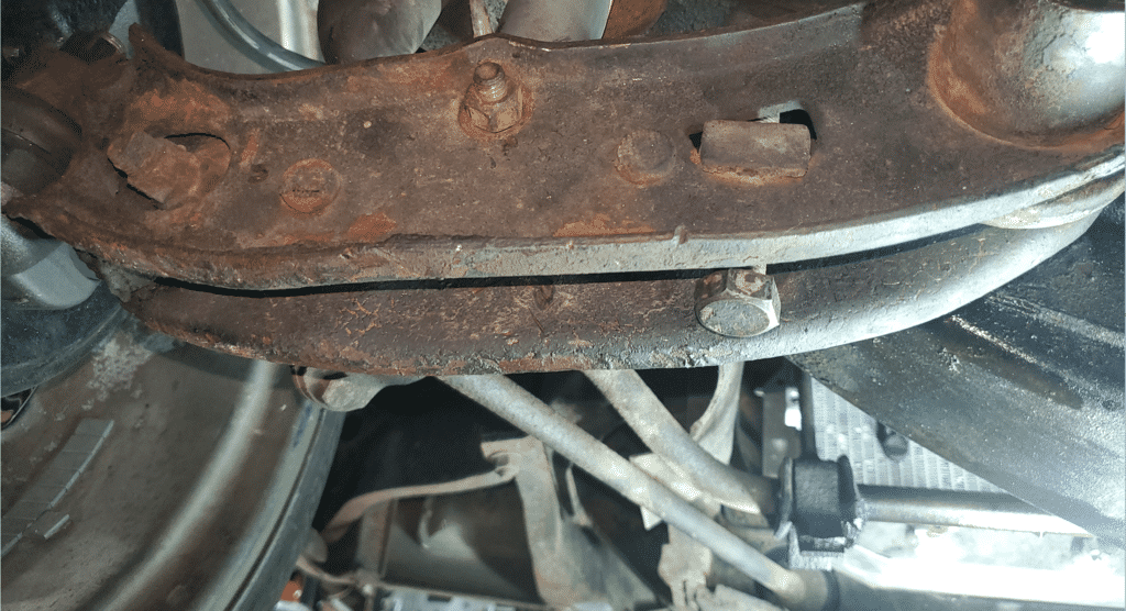

The next 2 pictures are closer up of the LCA's. The first one is the drivers side and the second is the passenger side. The drivers side is the side that is causing me issues.

If I make them around the same level, both left and right side, the car will be really uneven. Do I want to do that?
Your rear leaf springs are in trouble if you have to adjust the screws to get it level like this.
Wouldn't be surprised if you have a broken leaf...
That's good news. I'll assume you have matching shocks too. Your strut rods also look to be straight. So if your rear springs are new and you don't have a flipped hanger on one side then I think your down to two other possibilities; 1) badly worn or missing LCA bushing or 2) a weak/damaged bar. Either of those will require pulling the bars out so replace the bushings while your there.
Maybe someone else can think of other issues to look at.
Im with you on this call. Ive watched a ton of videos on getting those bars out and then the beast of dealing with 50 year old LCA bushings... I wish I knew a shop that would actually work on this thing when I dont want to. LOL

It's not as bad as it seems. You will need a shop to press out/in the bushings, everything else is bolt and unbolt. Remove the inner fenders and all is accessible. Properly supporting the car is the hardest part and the most important.
