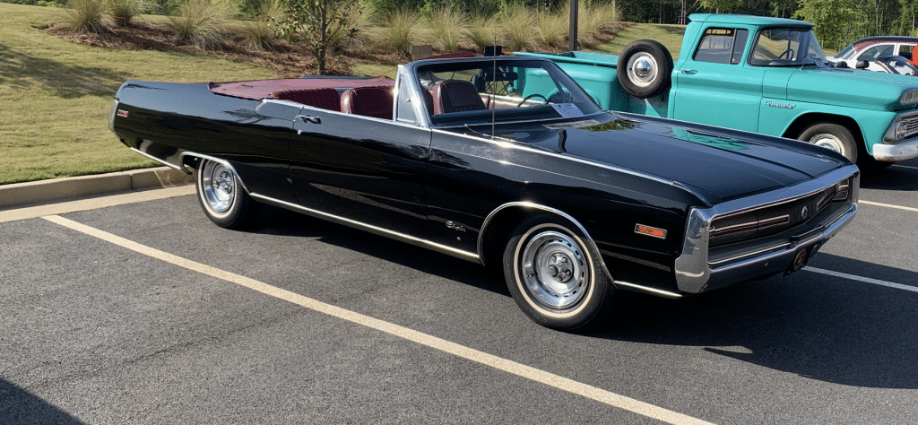

I think I’ll replace the whole electronic ignition package to start. Pretty cheap kit and would hopefully eliminate most of the things it could be. Forgot to mention the car is gorgeous
I would, had a similar issue on a 74 Imperial and that fixed the problem. Obviously electrical, whatever it is.

“Brutus”! A ‘70 300 went out for a Memorial Day cruise and he cut off after about 5 miles. Let him cool off and would run about a mile before cutting off again. Thought it was a bad coil, swapped it out but doing the same thing. Temp staying under 190, fuel pressure seems good (electric fuel pump) Hmmmmm… any ideas?
My 71 Fury did the same thing. It turned out my gas tank wasn't venting. The pressure built up and cut off the flow. I released the cap, heard the pressure come out and the car started. I had to do this every 20 miles on a long trip on a hot day.
