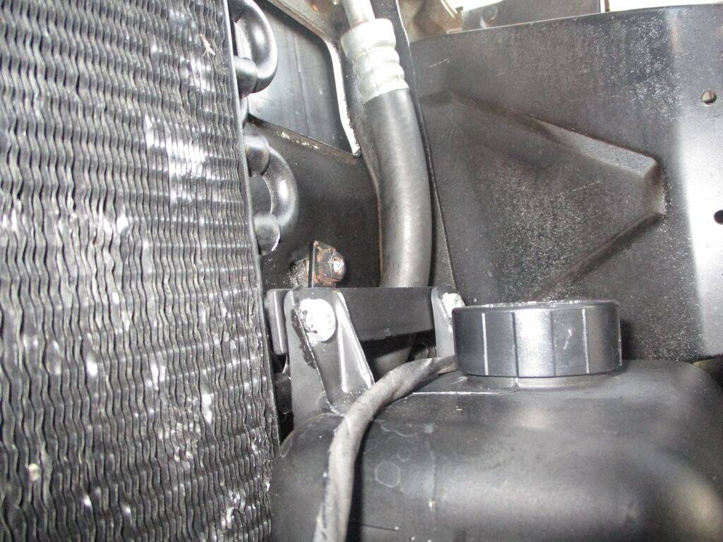

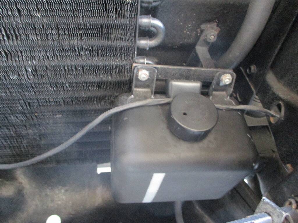

I bought a cheap universal reservoir, welded up a bracket to locate it on the forward side of the core support using existing holes and studs located there, painted it flat black, and ran the hose to the bottom nipple (for proper siphoning/air separation). The white unpainted stripe is so I can see the coolant level. In all the times that Mopar experts have nitpicked the OEM aspects of my underhood, it's never been mentioned. It's like it's invisible or something! :D
The closeup photos make everything look much more harsh due to flash, but I did allow a little "patina" to occur...scuff marks, a dot of rust here and there, etc. After all, that reservoir is 50+ years old!

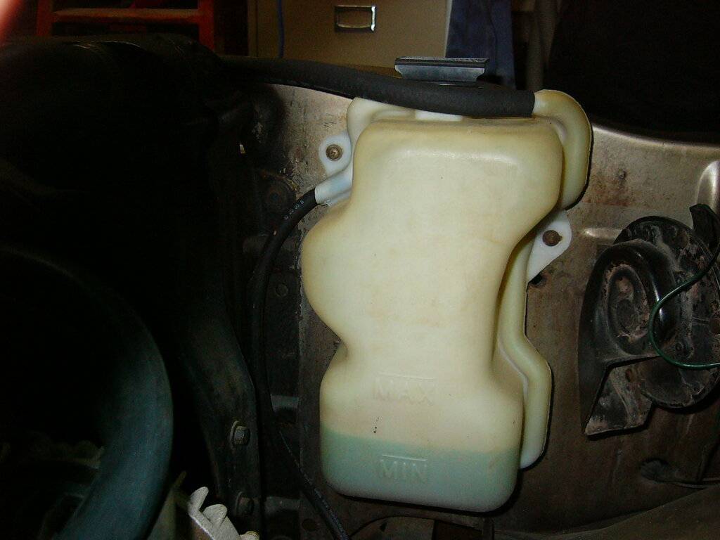

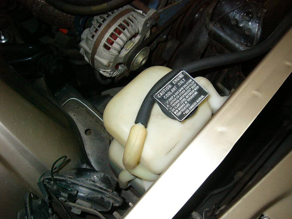

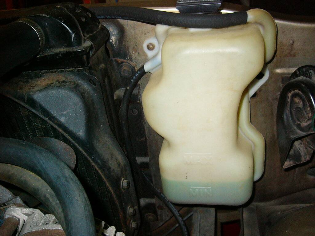

I used a reservoir from a mid-80's D150...

Agreed - looks exactly like what I hope to do.
If it were me (and it might be in the future!), I'd find a cap with a bit less "80's" wording and warnings for a more sixties-ish period appearance, but I absolutely love the idea of an overflow that already looks aged and certainly much more OEM than my generic aftermarket reservoir.

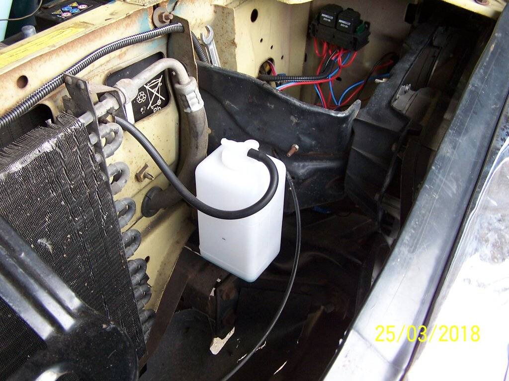

Dorman makes one that is eminently affordable, and I really like the idea of what @Trace 300 Hurst did - painting it semi-gloss black so it fits in with the other componentry under hood but leaving a stripe of white to be able to view the level.
I can get the Dorman one from my local Napa for something like $22 Canadian. That kind of price appeals to my part Scottish heritage!
