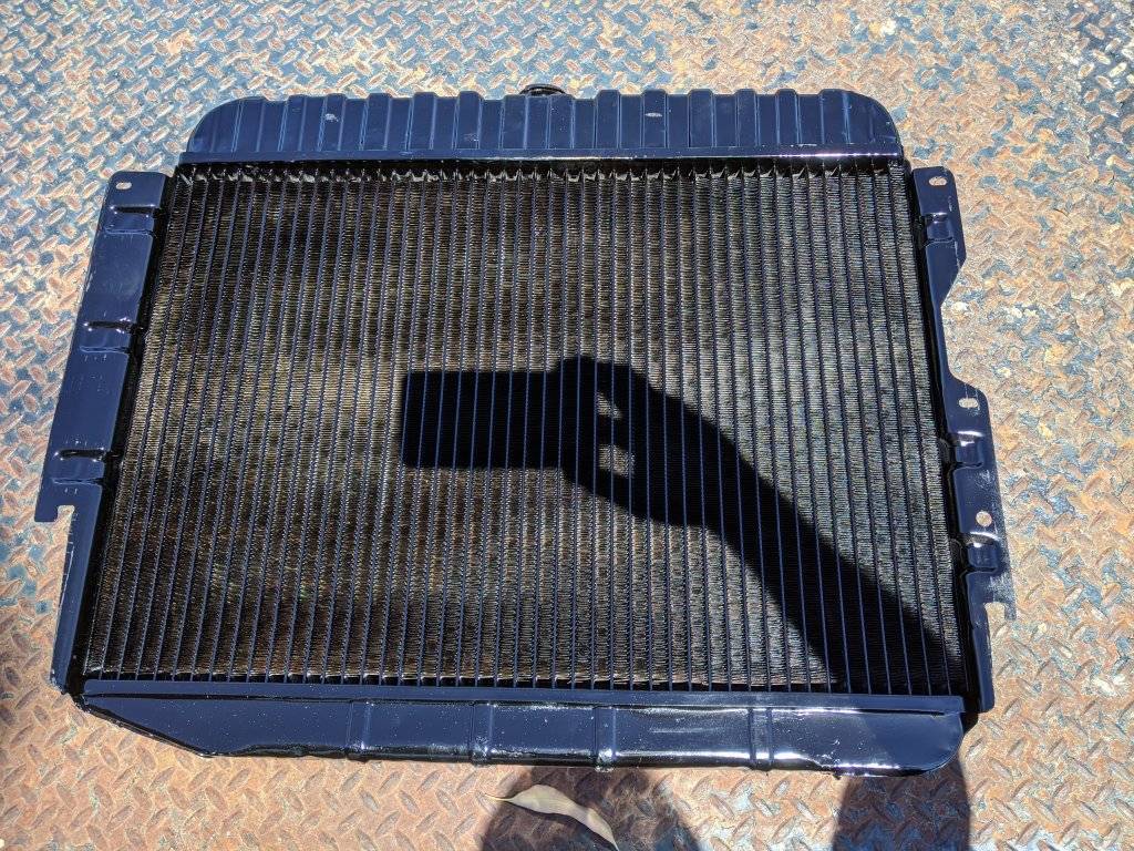

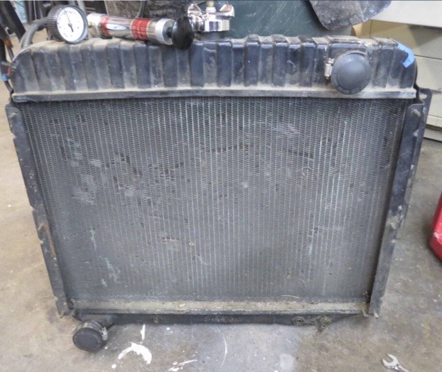

Well what do they say about famous last words??? I took my new old 26 incher in for a good dunking and it died on the operating table. Good bones but like you said no way after 50 years would it come out like new. The old pro said about 70% was all we were gonna get out of it. So I sprung for a new 3 row core. I’m going from a weezy 19 incher to this 26 inch so a 3 row will be fine for the 318. Price came out to about $400. He said the 4 core would be closer to $500. Tempting but I don’t want to have to run a shroud... there you go.

So you paid only $400 for a 3 row high efficiency 26"radiator recore out the door for $400?

It has that block off plate so I figure if I pull that this rad will fit the cut out perfectly. I just couldn’t get past $400 to repair that little 19 incher when Matt had this big one available.

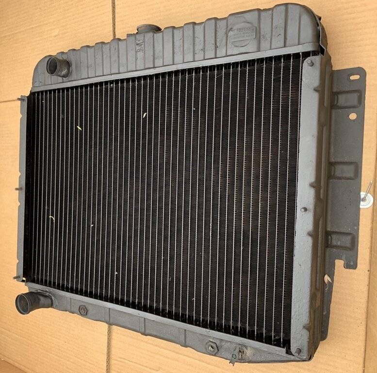

I just priced a core rebuilding for a 61 Plymouth 383 Manuel trans rad at a old time radiator shop. The quote was between $500 to $600. When I think about it that's not to bad considering I will never find a good one elsewhere. I should have done while there is somebody around with the skills to do this kinda work. Kinda like finding a 45rpm juke box repair man. A lost skill.
Yup I only paid what I did because my buddy retired and closed his shop in Bako. No more dunking for him. My second choice was the cool old cat up the street from our CAT store. He’s old school and really good but no freebies out of his shop Lol!!!
If you look at my pics you can see I had him move the inlet on the top tank to ape the one on my tiny 19” rad. This way I can stick to the factory hoses. Nothing against flex hoses but I prefer molded to flex. By doing this you can swap radiators at will and you won’t be hampered by routing the hoses in some crazy fashion.
