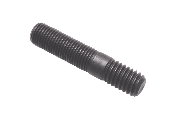

When I pulled the 6 manifold-to-engine nuts, on the very last one, the whole stud came out. There was coolant behind that stud, so I was momentarily unnerved as anti-freeze started spilling on the ground. If it had been any nut other than the last one I might have been able to deal with it, but with the manifold now dangling, and all of my catch pans filthy, I just had to watch a gallon or more of perfectly good coolant go to waste.

I am also interested in replacing the 2 exhaust manifold-to-exhaust pipe nuts and bolts, the 6 manifold-to-engine nuts, and the manifold stud that unscrewed from the engine. Any guidance on replacements is appreciated. Is stainless on the nuts and bolts a good or bad idea? If not stainless, then what grade and/or material fasteners am I looking for? As for the single stud that I need, can I just go to the dealer and get one? Do I need a part number? Maybe someone who bought a kit didn't use them all and will sell me one?
