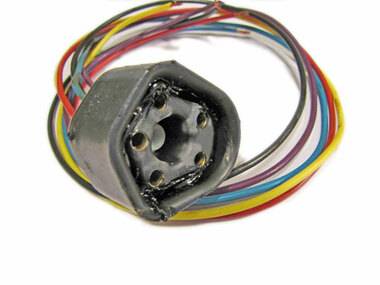

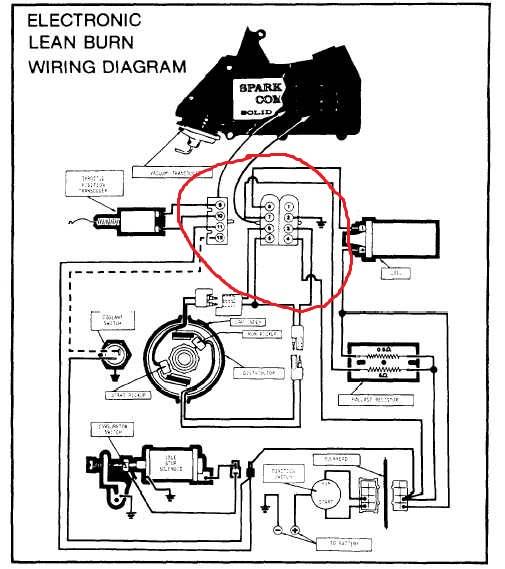

Since your car originally had lean burn/spark control, the plug with relevant wires should look like this:
The Mopar electronic ignition has a plug that looks like this:
Yes I have found a number of fit issues with the ones made in the last 20 years or so. I just trim some of the rubber on the inside of the plug with an Exacto knife.
