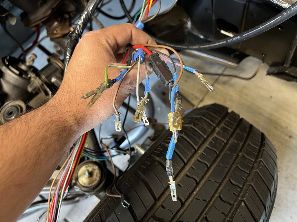

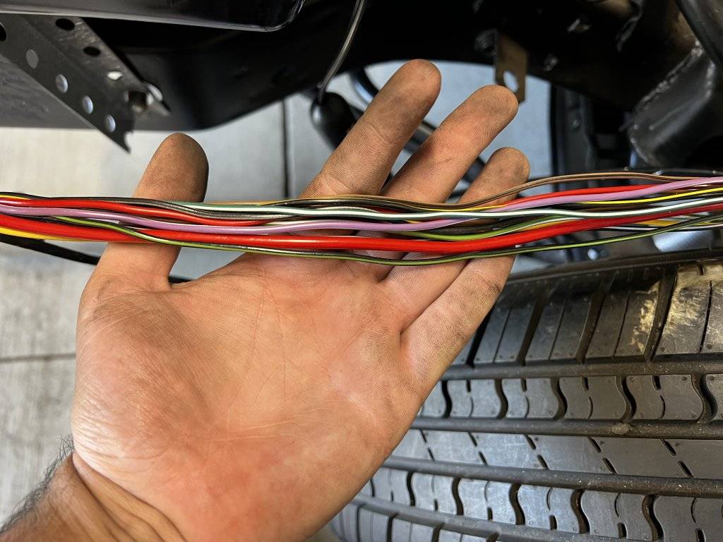

Began to tear into the factory wiring harness of the 68. Amazingly the rats didn’t chew it up, and the tape loom, although crunchy was still intact. I guess I shouldn’t be surprised, but I am - this wire looks BRAND new for its age.
Now to replace all the blade connectors and install them into a new bulkhead. Will be bypassing the ammeter along the way and adding a new headlight relay harness into the mix and then I’ll tidy it all up with new looms.

Looks like you are coming along. Good job.
I'm not surprised by the wiring shape at all. As long as it hasn't been overheated the wires last a long time. Mice don't chew the old stuff the way they do the newer vehicles. All the new cars are mandated by the gov'ment to use bio degradable insulation and they make it out of oil from plants, so naturally to a mouse it smells like a food source. That change by uncle Sam has cost , OEM's, Dealers, insurance companies and owners billions of dollars in repairs. I also know of a few lives lost because of fires starting due to this. I love it when they protect us from ourselves. lol

Don't replace any of the blade connectors (or their female counterparts) unless it's obvious that the wire is getting ready to fall off. They are perfectly good if they're strong. Just wire brush them and reinstall. Those ends are machine installed - and unless you have a quality Packard crimping tool (as has been discussed in a couple of different threads here on the board), they're not as easy as one might think to install new ones properly.
I hope you labelled all the places those are supposed to go back into - I usually did one at a time to avoid screwups.
Wire terminal crimping lessons
Agree. Corrosion is the enemy when it comes to these terminals. Sometimes I've added solder the factory terminals to make them more bullet proof, because if they're in an exposed location, corrosion breaks down the connection between the terminal and the wire.

“Replace ALL the terminals“ Really bad idea.
Fix any problems, but don’t create any new ones along the way.
Seems to be a theme here. Not that I disagree, just wondering why it’s a bad idea? I just assumed it may be good to replace them! Good thing I posted here before.
