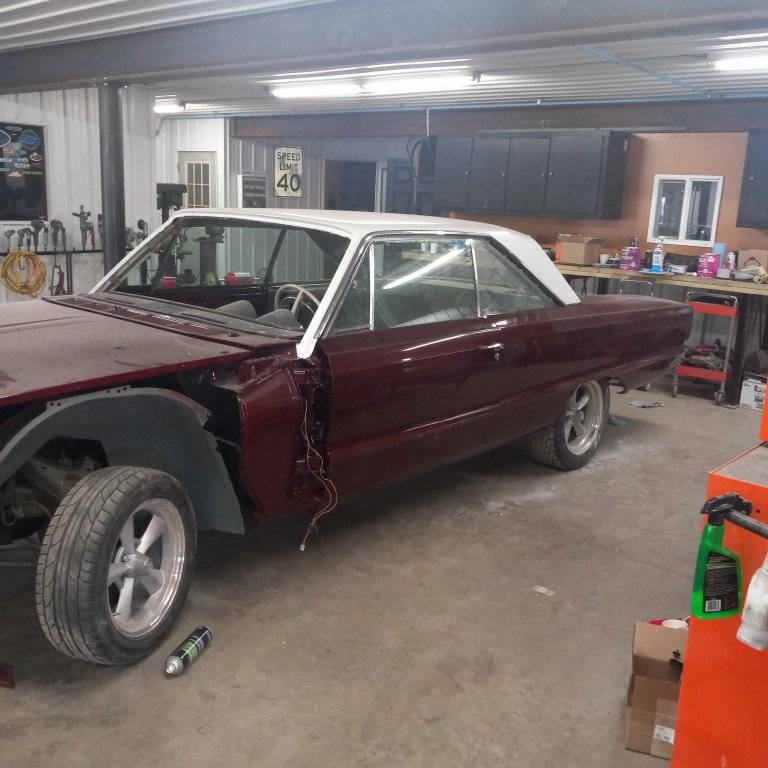

I have 255/50/17 on an 8" rim on my 65 Monaco. I've never had a problem with them rubbing or hitting. The key is wheels with zero offset. Getting them off and on requires jacking the car up by the front spring perch so the rear axle hangs. The pictures aren't great. It's still in the body shop.

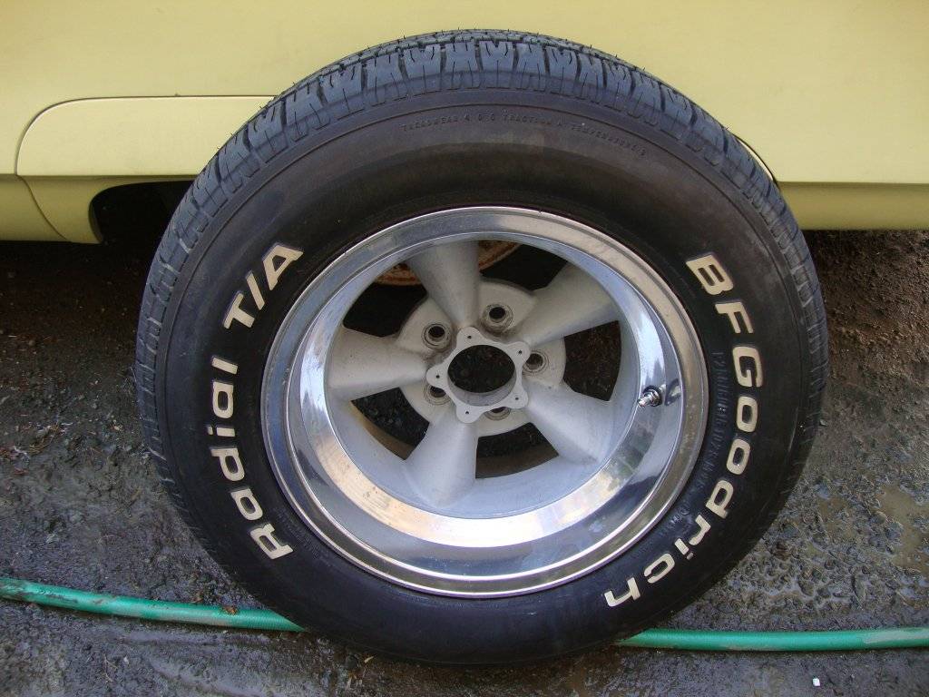

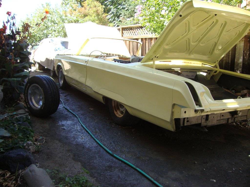

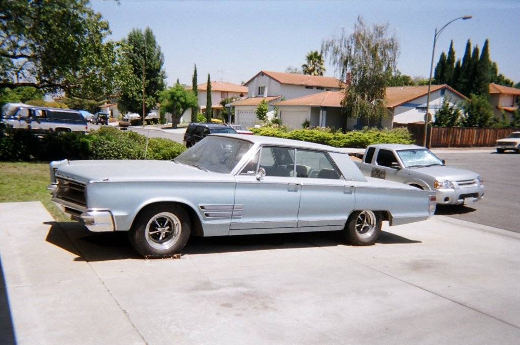

these are 15x8's and 275/60x15 all the way around . we needed to do a slight mod to the skirts to get them to latch . this is my 67 300 with 60's vintage american torq thrusts 15x8.5 with 245/60x15's on the rear . but i change the rear end out for a 66 67 b body one to help with the 1.25 pos off set on these rims . skirts fit with no issues .
