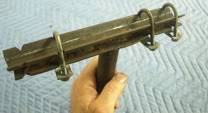

I saw a magazine article about rebuilding an entire front end, and they showed how to make a torsion bar tool out of angle iron and a piece of tubing. I'll look around for the picture.

Here's the picture. The article was called "Torsion Bar Front Suspension Rebuild Tips and Tricks" from Mopar Max Magazine.

I'm curious if that would facilitate the larger diameter torsion bars our C Bodies are equipped with.
I don't see why not, it would depend on the size of the angle and the size of the u-bolts. If you were really worried about not scuffing the torsion bar, you could even use aluminum angle, which being softer than steel would be less likely to mar the surface. I think I happen to have some left over from the old race car stash...
But now that I come back to the thread, I see that the same article I pulled the picture from was the one linked a couple pages back.

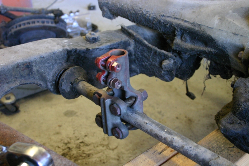

No idea what this is but it works like a charm.
I do know it is a electric utility item, not sure if it is a tool or a tap or?

Looks like a connector for HV tubular busbars used in many outdoor electricity substation yards. Or some very thin scaffolding...

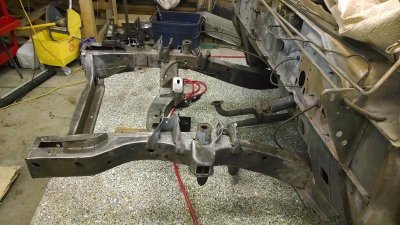

My buddy brought the tool over to remove the torsion bars and now the front suspension is completely off. Yanking on a loose torsion bar and smashing you finger between it and the frame doesn't feel very good.
