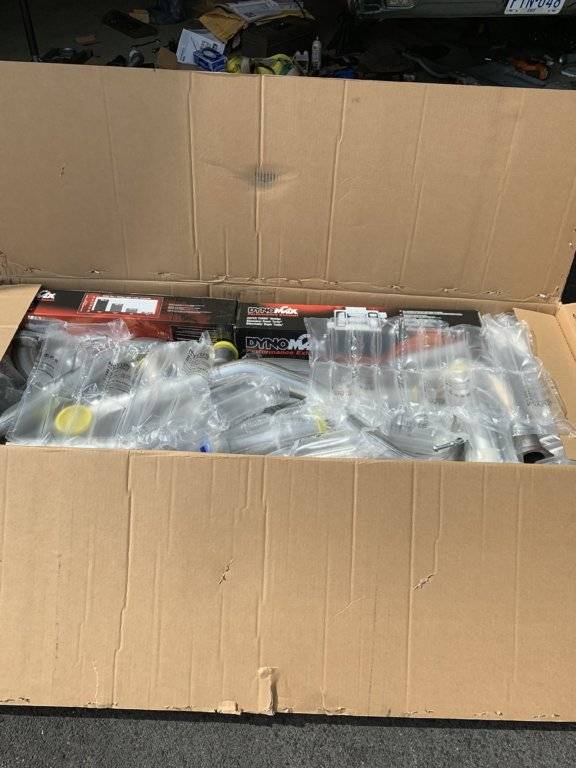

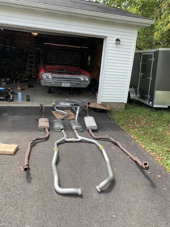

Some pics of how the exhaust is packaged. I got the mid hangers installed and began assembling the drivers side piping today. Hopefully I’ll get close to finishing it up this long weekend. I never got the opportunity to ask TTI for band clamps and they didn’t offer over the phone so I’ll just go with the supplied ubolt clamps.
