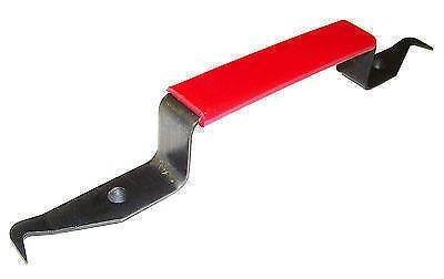

If is like my 67 Barracuda you will need a tool like this
You slide it in between the glass and the trim and hook the clip then leverage it away from the trim.
A little tricky and sometime years of muck make it difficult.
Alan
I have used these with some success but they take patience in the beginning until you get the feel for how the clips release. One thing I would recommend is to wrap masking tape around the shaft where it contacts glass and the trim. You may have to replace it as you go but it helps protect against scratches. This is a little off subject but I have had success removing drip rail molding with a bottle opener with masking tape wrapped around the end. If you go slow you can get it off with do dents or scratches. FWIW.

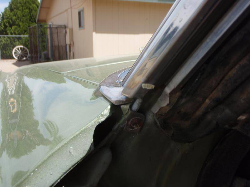

Don't know the difference from 65 to 67, but here is how my 65 is done. The spring clips just pop down through a 5/16 hole near the front edge of the trim.
You can see the holes in this picture

Kidding, really. Back in the day I must have cracked a dozen wind shields using that tool. You really have to be careful, the slightest bit of pressure against the edge of the glass will crack it. I would hit the junk yard and practice first.

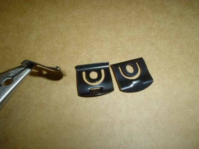

I think I got my own just by pulling gently them out and putting fingers close to clips. I suppose you have the similar clips as I in my Fury, here is a picture of the side and upper clips, but the lower are a bit different shape, but the principle is the same.
Would you take a picture of the lower clips once you get that of? I don't understand where are they attached to and don't have any pictures from the time before removing them...
Yes. Definitely there are other things i can keep busy with.
I have removed the trim from about 10 windows and I was far from gentle and never had an issue. I did put tape around the heal of the tool but that was it.
The tool is only to release the clip and only release the clip.

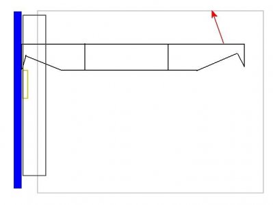

You slide the point in behind the clip and rotate the tool along the glass, the part away from the point (on the same end) is the pivot, the opposite point only needs to move along the glass an inch or so
You need to lift the trim with your fingers. I use clothespins and stick the flatter part in as I go to prevent the trim from seating itself again.
If the 67 is like this (which it probably is) then it just pops off, just get your lifting device as close to the clip as you can.
