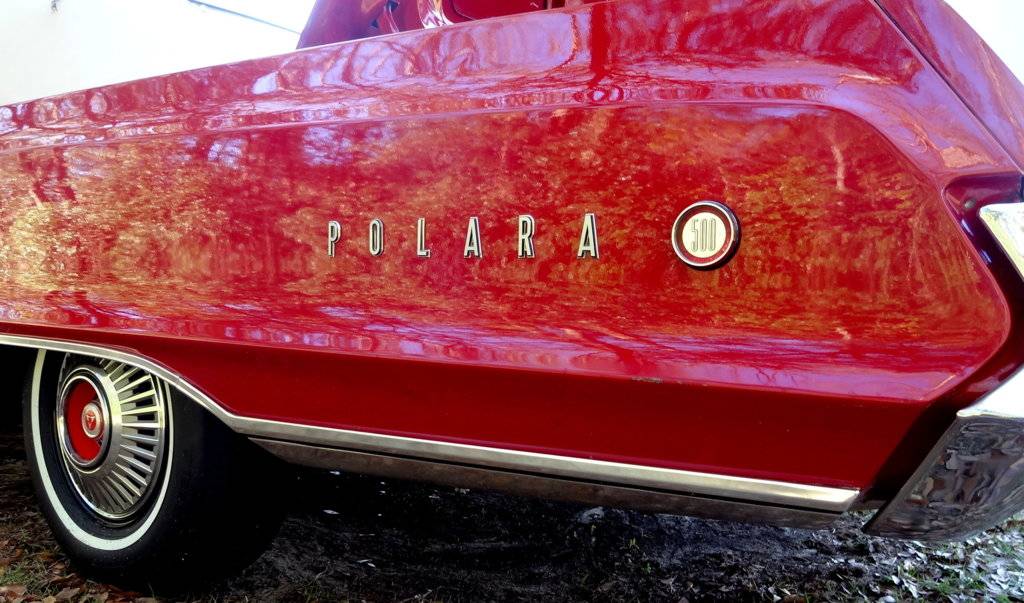

Will's red Polara came back very well. Most of our 50+ year old cars might not fare as well. If they do have original paint on them there is a good chance it's so thin in spots that buffing is out of the question. They didn't put anymore paint on them then they had to from the factory. Here in the desert southwest even moderate exposure to the hot sun will bake the paint off down to the primer or even bare metal. Another variable is whether it's a metallic color. Metallics don't hold up as well as solid colors and also don't buff out as well. If the original poster is asking about his Fury in his profile it looks like it's LL1 Dark Turquoise Metallic. If you are going to attempt it yourself follow the good advice that has been posted here. Start with the least aggressive and work your way up. Test each step in an inconspicuous place if possible. Good luck and we want pictures of the progress.

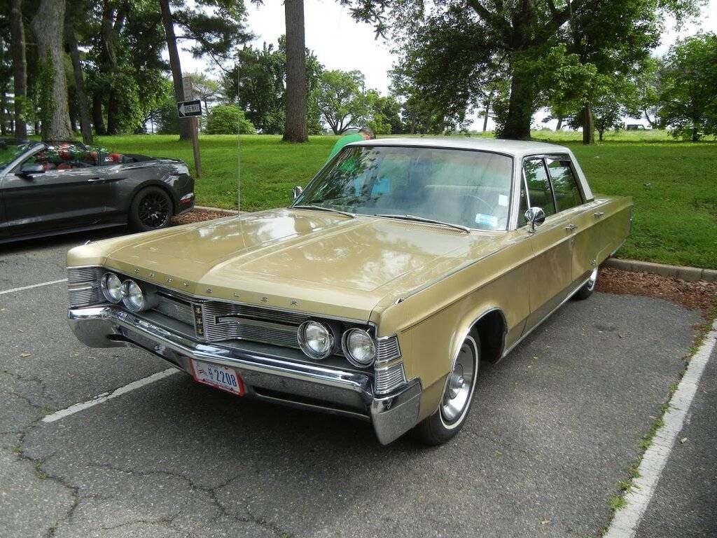

Most everything has already been said, by sources with WAY more experience than myself, but since your Fury is the same age as my New Yorker (see photo) metallic with original finish, and I started with little knowledge, maybe my $.02 will help.....
I found the following link helpful:
The Secret to Removing Oxidation and Restoring a Show Car Finish to Antique Single Stage Paints
I started with this, with some advice from others on here, and had reasonably good results. Out of an abundance of caution (and lack of knowledge) I did the least "aggressive" sounding steps skipping the clay bar as I was afraid of doing damage with it. No buffer got anywhere near the car. Here's what I noticed:
The Meguiar's #7 was gentle, and really seemed to lubricate the finish. I did the whole car with about half a bottle. Takes a while to remove, but seemed to make the paint easier to work on too.
I stuck with the most natural products, avoiding abrasives or chemicals. After the Meguiar's, I used Zymol cleaner/wax, which was a liquid. Finally I used a couple coats of carnuba wax, using only a sponge applicator, and soft cotton cloths. Step by step the finish brightened up a good bit. Definitely not as well as the red Polara, but I got a good sheen, and the cloudiness went away. A goodnumber of spots, blotches, etc., remain, but the paint is preserved, and presentable. Didn't know about the Dawn wash, sounds like a good first step. Good luck, and hope this helps.
