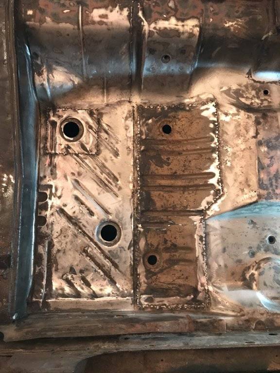

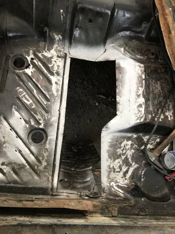

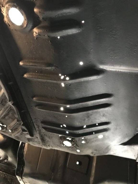

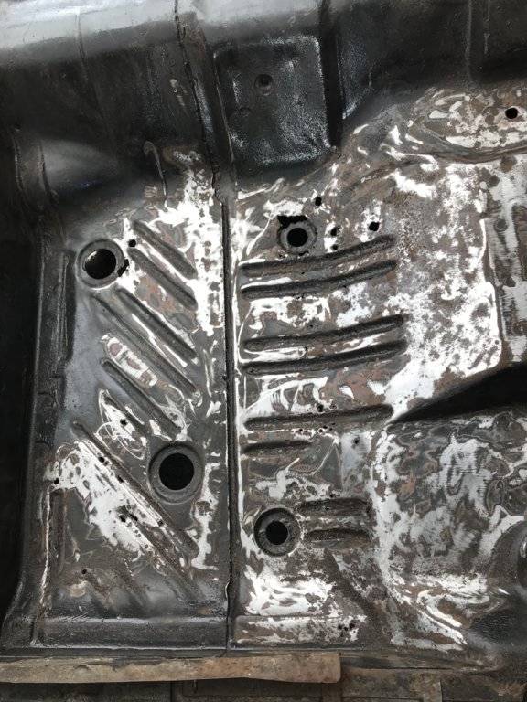

So, after removing the old undercoat, more pinholes appeared in the floor. I took a page out of Wollfen's book and cut out the bad and replaced with decent metal from the '73. This will be the only section of flooring I'll need to replace.
Ooo, look at all the pretty lights!
Taken from the top.

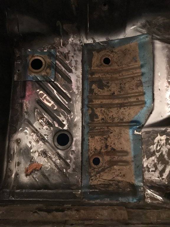

Outline of the cut-out on the new metal:
Not too shabby!

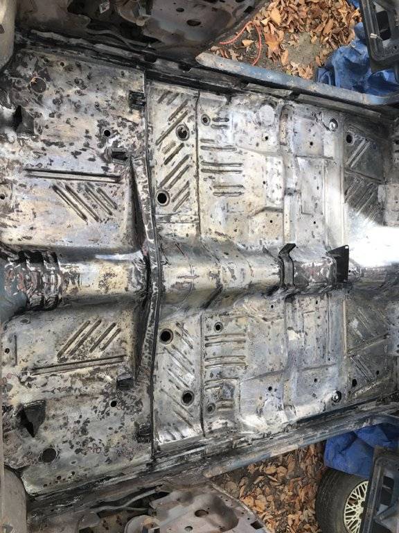

A few final images to finish up 2017.

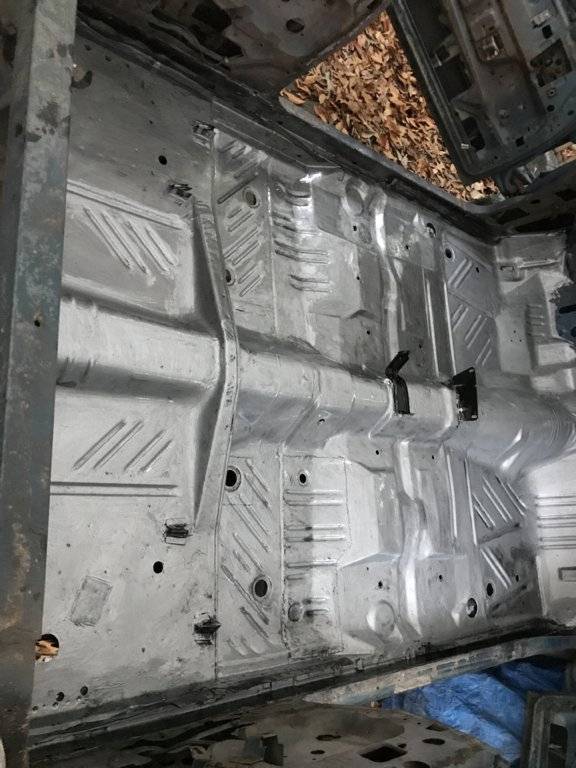

the floors after a nice soothing bath in phosphoric acid.
A double coat of POR15 in black and then silver.

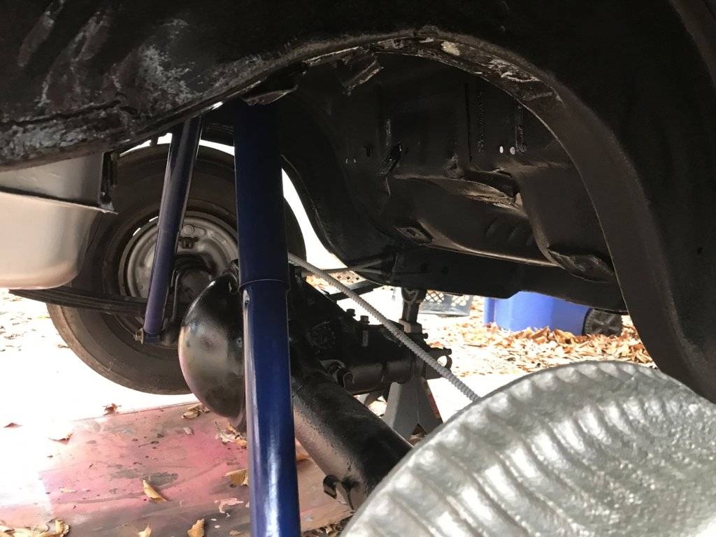

Shocks installed. E-brake cables installed.

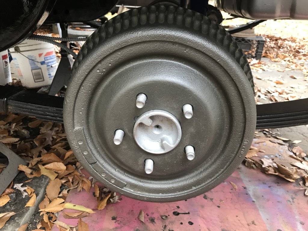

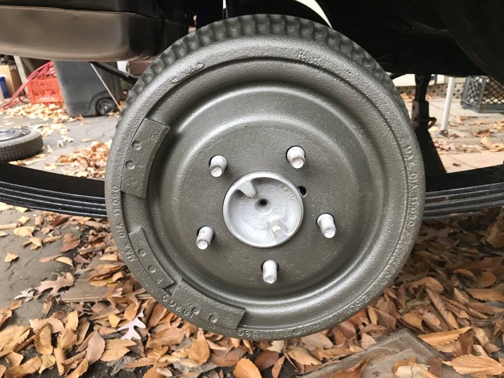

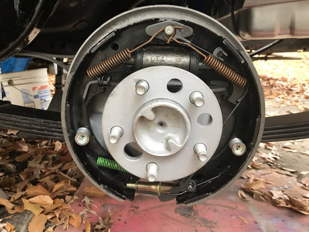

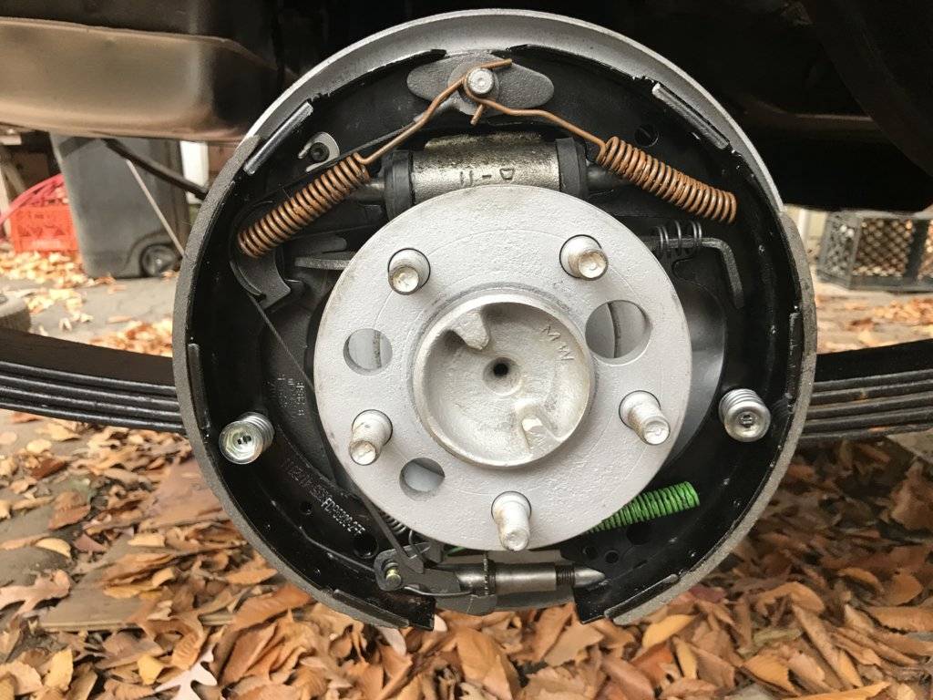

Refreshing brakes.

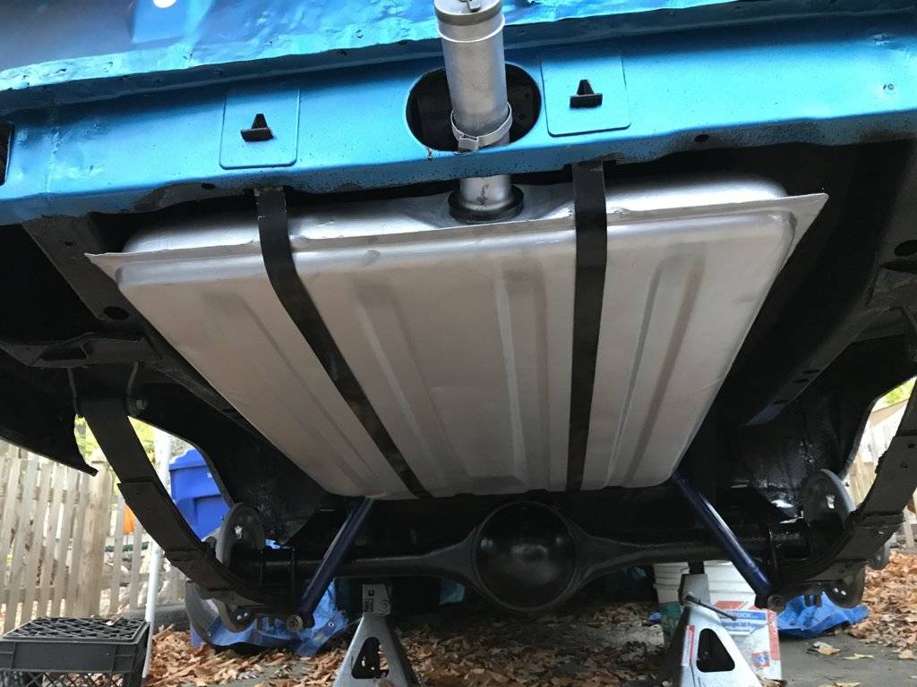

Gas tank installed.

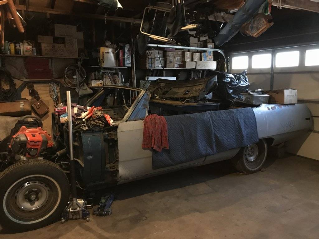

One more parting shot. Finally stored in the garage for the winter. My wife had the suggestion for the extra workbench in rear seat area so I can get some work done on the dash over the winter.
