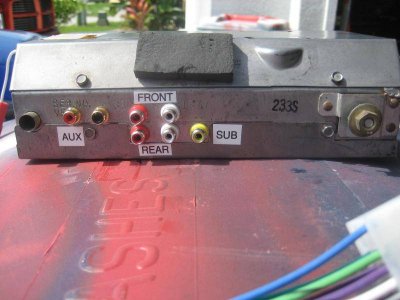

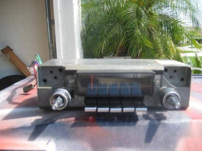

Here's the radio for my 66 Charger that SM Electro-Tech did for me. They cleaned it up really good and even checked to see if the EL lighting in the radio still worked. Which it does. I'm hoping to get it into the place that did my seats this week. I'm going with 2 JL 8.8 marine speakers and 200 watt amp in the fold down to the trunk. Should fill the charger with some nice sound. I ran a cable for the Aux in along the dash, into the channel along the driver's door, then across with the wiring for the center console and shifter then into the center console to plug my phone in for tunes. I made sure i had enough cable so I could pull the phone all the way out of the center console and still be connected to the radio.
