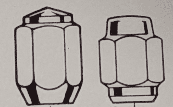

The 3461218 and 3580134 lug nuts are slightly shorter than the 3580286 which is slightly shorter than the 2823848 lug nut. A comparison diagram from the 1976 service manual shows the difference between 3580134 and 3580286:

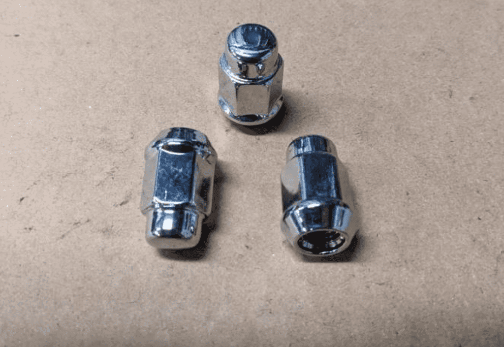

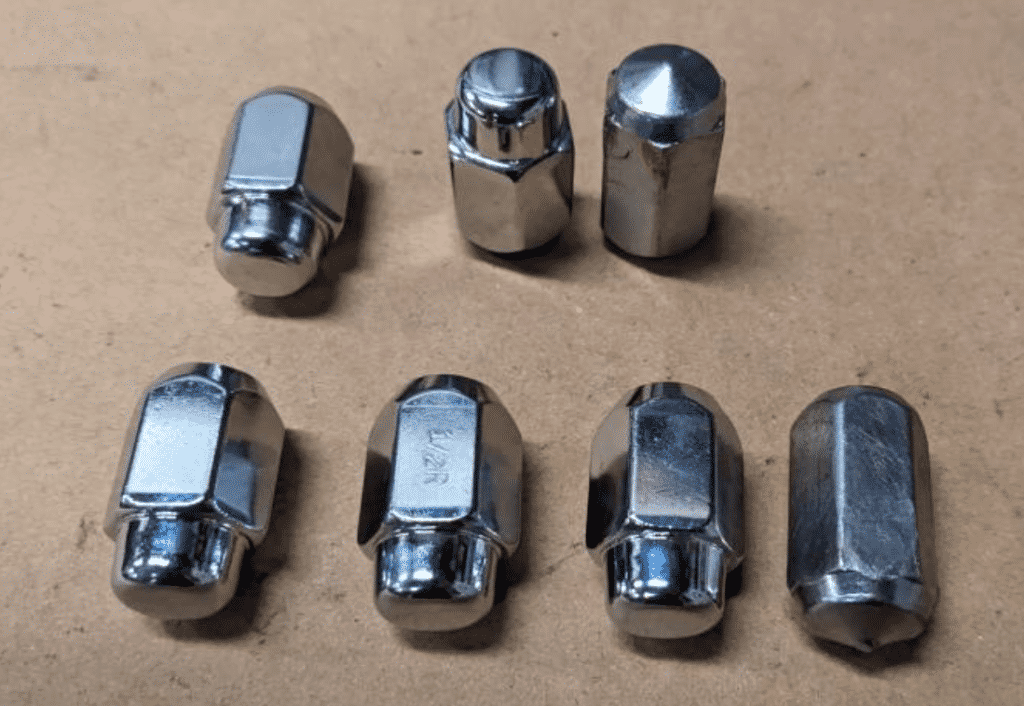

Many aftermarket chrome lug nuts are available including the bulge style which can compensate for mounting hole/cone wear, some in a 3/4" hex, or a larger hex 13/16" style. The 13/16" hex size nuts can have a tool clearance issue in some center domes/caps. Dorman makes some 3/4" hex replacement nuts, although they are styled differently, such as the number 611-094, or the shorter solid chrome replacement for the stainless steel capped nut, number 611-091.
The following images show these details:

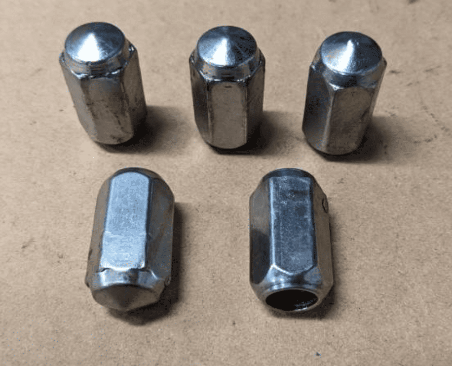

- original 2823848 nuts

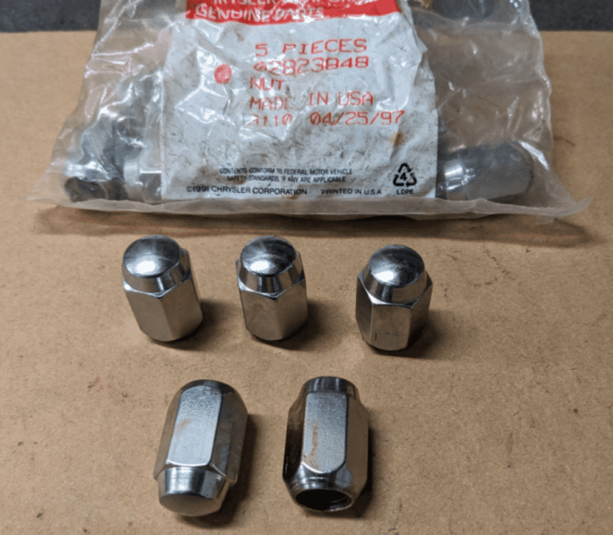

- replacement 2823848 nuts (which are slightly shorter than original 70s 2823848)

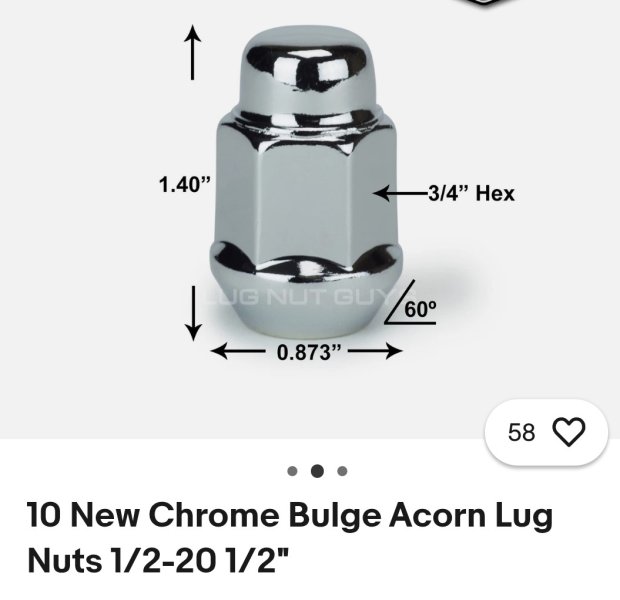

- aftermarket bulge nuts with 3/4" hex
- 13/16" hex aftermarket nuts compared to original 3/4" hex
Both aftermarket nuts shown in the following have different end styles than original nuts.
I don't have any 3461218 and 3580134 to show in a picture. I have used 2823848 with later 1970s 16-slot wheels.
- original 2823848 nuts:
- replacement 2823848 nuts:
