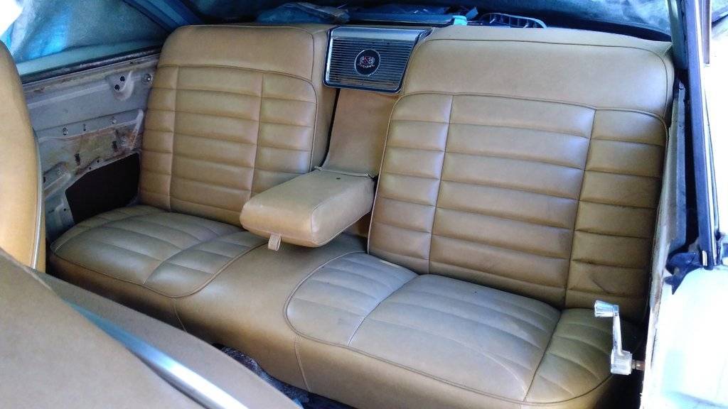

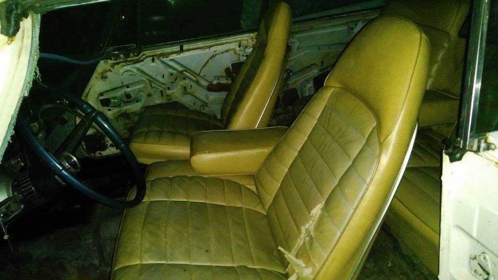

The '73 interior looks great! The back seat is a perfect fit!
The bottom of the seat dropped right into place. The back was a different story. We had to wrestle and hold our mouths just right to get it to slide in and that's without the quarter panels in place.

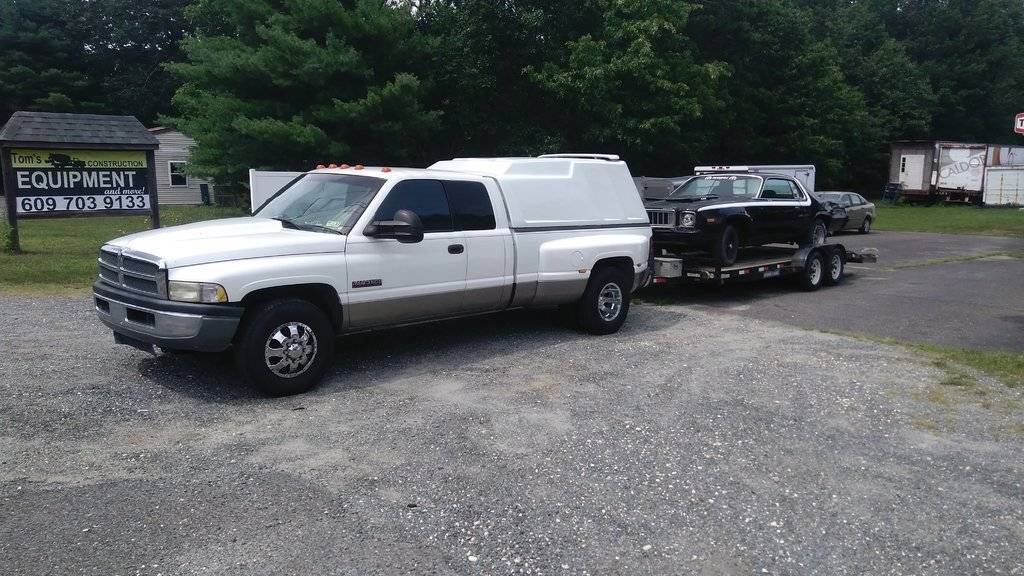

'75 Road Runner all loaded up and ready for the ride back from Egg Harbour New Jersey back to Princeton WV. Got up at 3:00 AM on Saturday morning, drove to the car, picked it up and drove back non stop. Got back in bed 3:00 AM 24 hours later. Long Day.

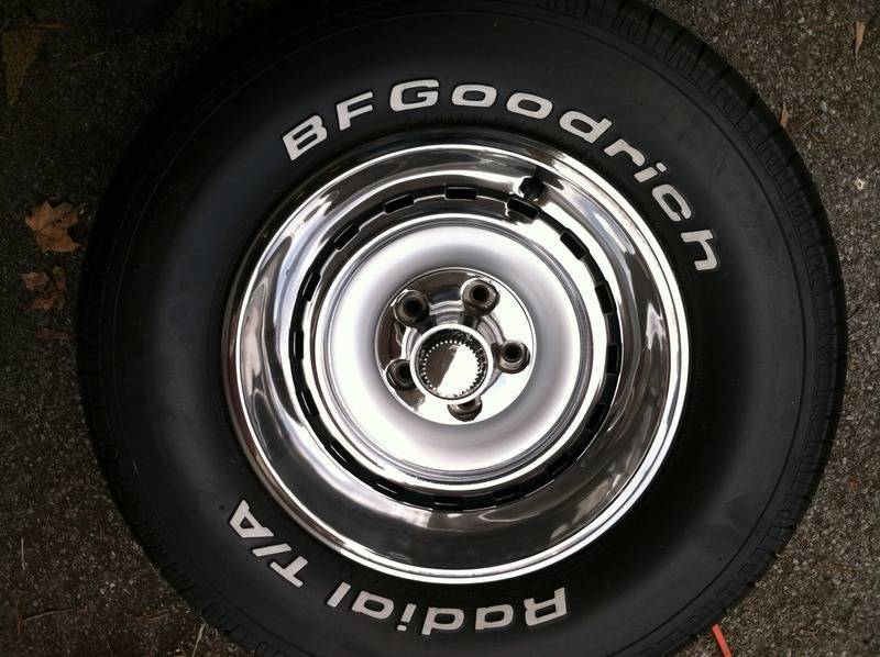

Just be aware that finding a good set of wheels, domes, caps, and the Road Wheel only trim rings is going to severely set you back.
You can use an aftermarket trim ring. If it's going on a '61, that little bit of originality won't mean squat. I don't have "correct" trim rings on mine and only one guy (Dave) has ever noticed.

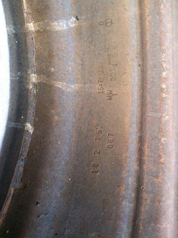

IIRC, stockers are 6".
Later wheels could be had in 15" x 7". I think mine are off a Diplomat wagon.
View attachment 139345 View attachment 139346
