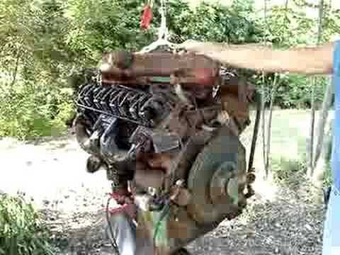

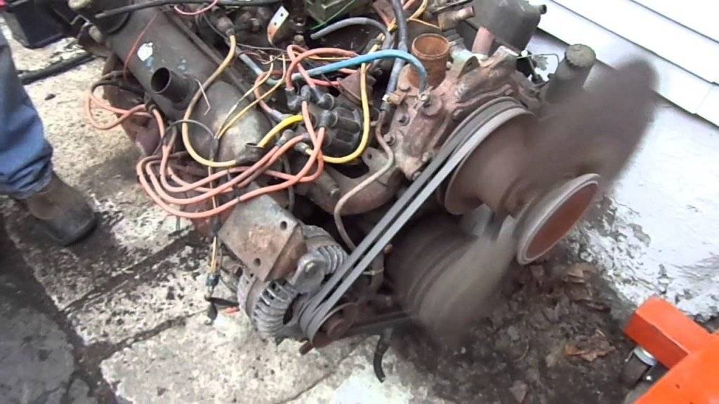

I will never say absolutely 100% but the funny heads have a water fitting right in the front , coolant does not have to pass back through the block to get to the water pump housing and thermostat neck. These heads are the ones with the different exhaust bolt pattern, mostly 413s
These are a couple of pictures best could find, top one shows exhaust and funny spark plug location. Bottom one shows the coolant flange /plumbing. They also had reverse rotation cams that were gear driven, they did not have a idler gear like modern gear drives have to keep cam spinning the same as with a timing chain.
