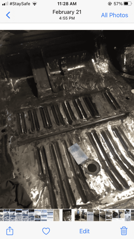

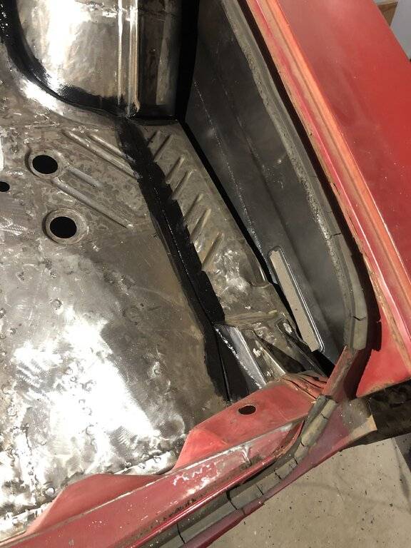

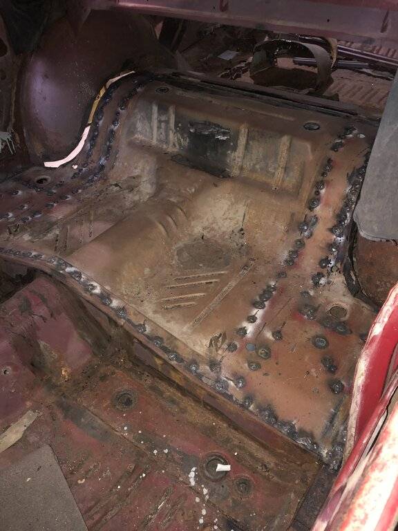

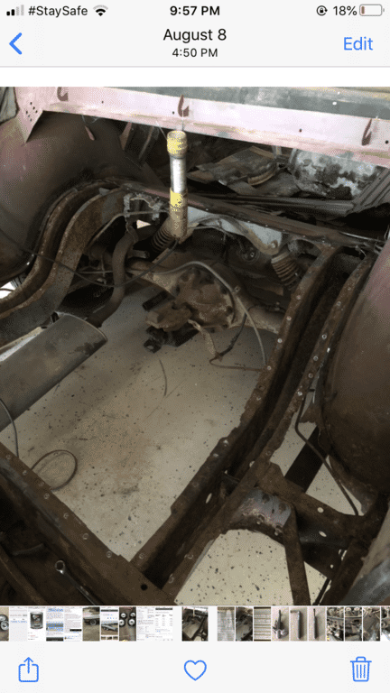

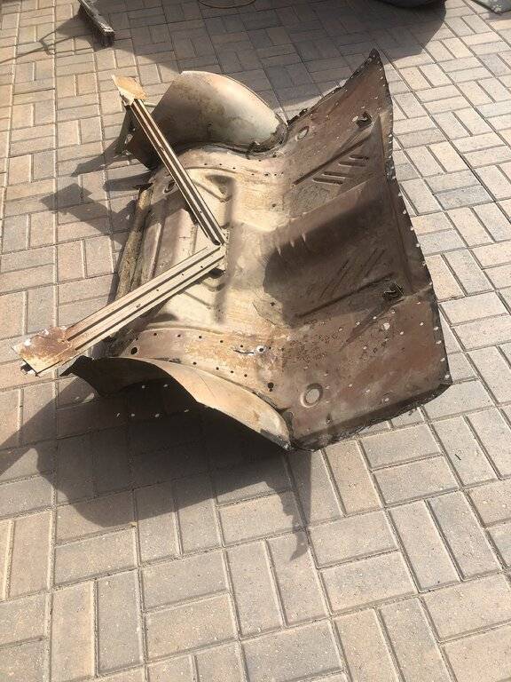

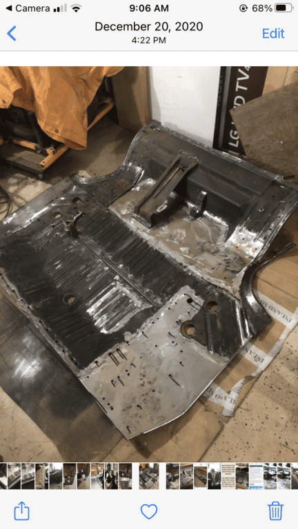

First thing I replaced was rear floor that I saved from the 69. The only difference from a 4 door and a 2 door is the position of the rear seat supports. The 2 door sits further up so make sure you save your old bracket to use over and weld to floor.

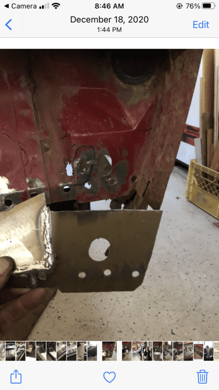

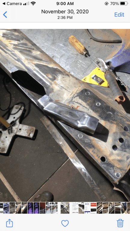

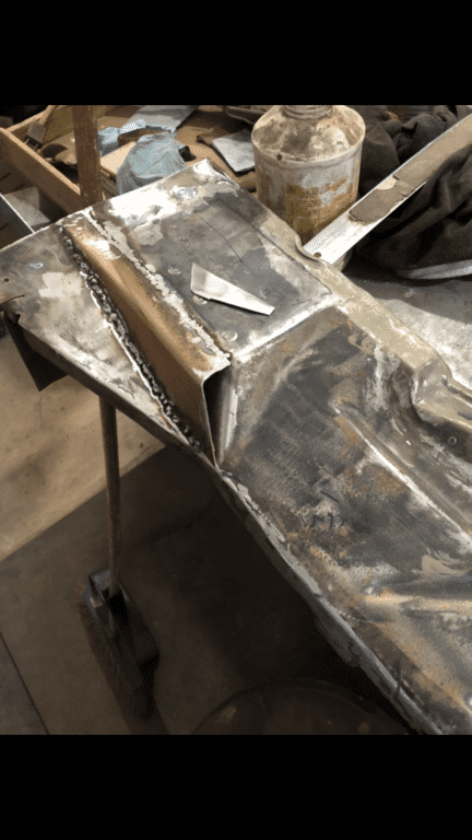

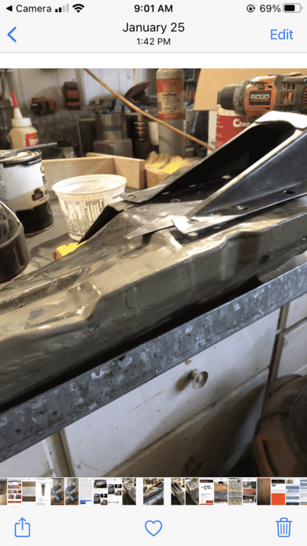

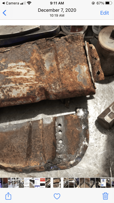

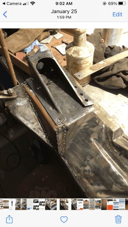

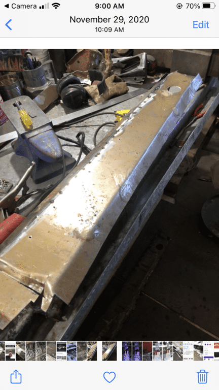

Next was trunk drop downs. I ended up using the tops from the 69 and pieces from the 71. The sides on all the ones I had were getting thin so I replaced with new metal. Not exactly factory correct but lots of good metal to weld rear fender to. The 69 sides are round and 70 are square to accomodate the different bumper styles.
The tops on the 69 are narrower at the rear where the bumper bracket goes so you have to widen to make work. You also have to reuse the indented pieces from the 71. The dents on side are to allow the two bolts and wiring plug for the side marker lights.

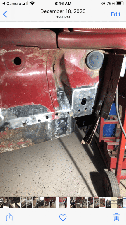

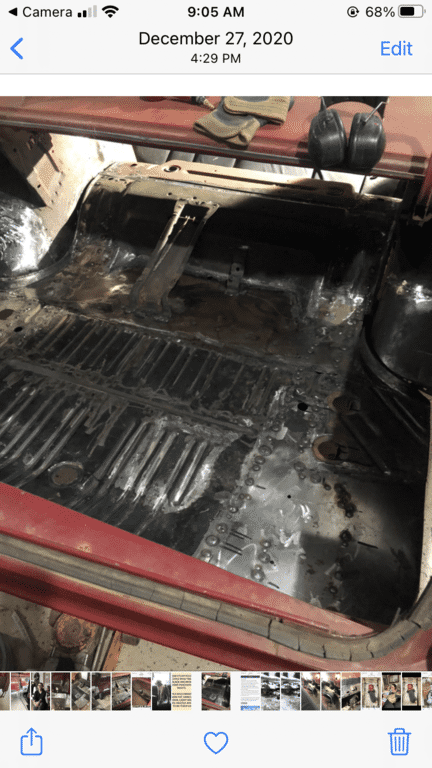

I removed trunk floor from 71. Once I scraped the seam sealer I saw that it was weak in a few places so replaced with new metal and welded it into place. Also welded the drop downs in so trunk is solid again.

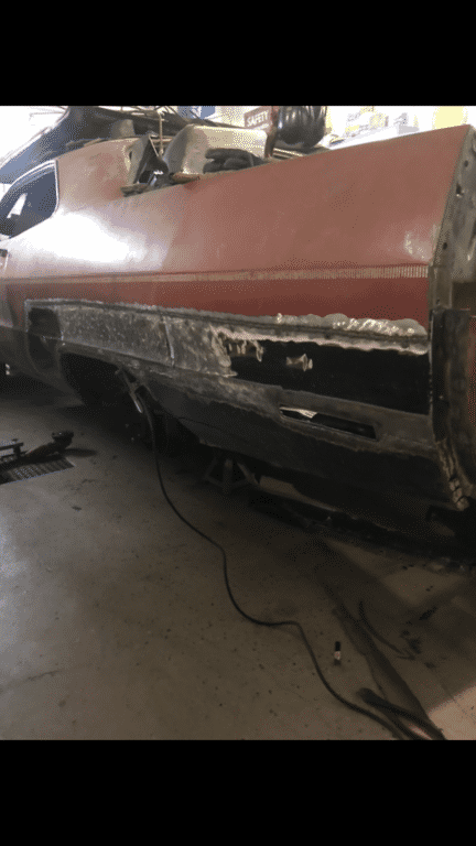

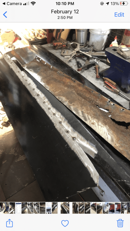

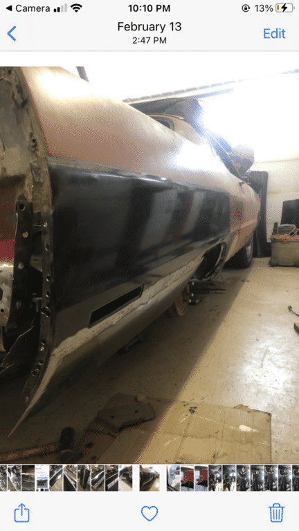

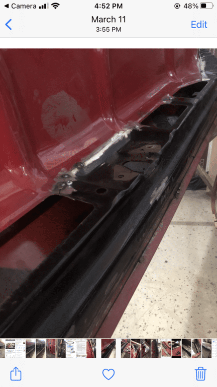

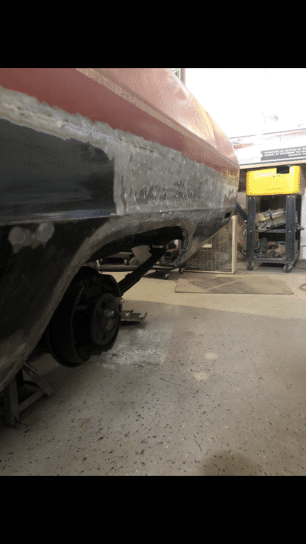

Well onto the rear quarters. I had to make a hillbilly quarter panel for drivers side by welding the rear passenger door from the 71 to the rear quarter once I got it removed . That whole driver side on the 71 had previous panel work from accident that I had to deal with along with rust on bottom of rear quarter. Got it stitched on and onto passenger side. Ibus

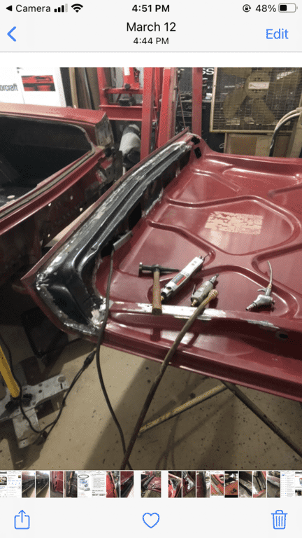

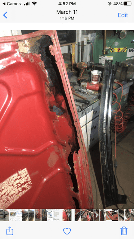

So last thing I worked on was trunk lid. I decided to repair the original trunk lid as I don’t know when if ever i will get around to a complete paint job. That way it will still match the rest of the car. And like every piece I have used to replace panels, with the exception of the rear floor, I have had to fabricate or repair. Trunk was same. So I put away welder and will start bodywork and primer paint. I won’t do that until the weather warms and I can leave garage doors open. Too messy and I don’t care for the smell and fumes. Once weather gets nicer I plan on spending as much time camping, canoeing and travelling as I can with our short summer and after this long lockdown. Don’t plan on spending it in the garage. Hope you have enjoyed my ramblings and wish everyone the best during these difficult times.
